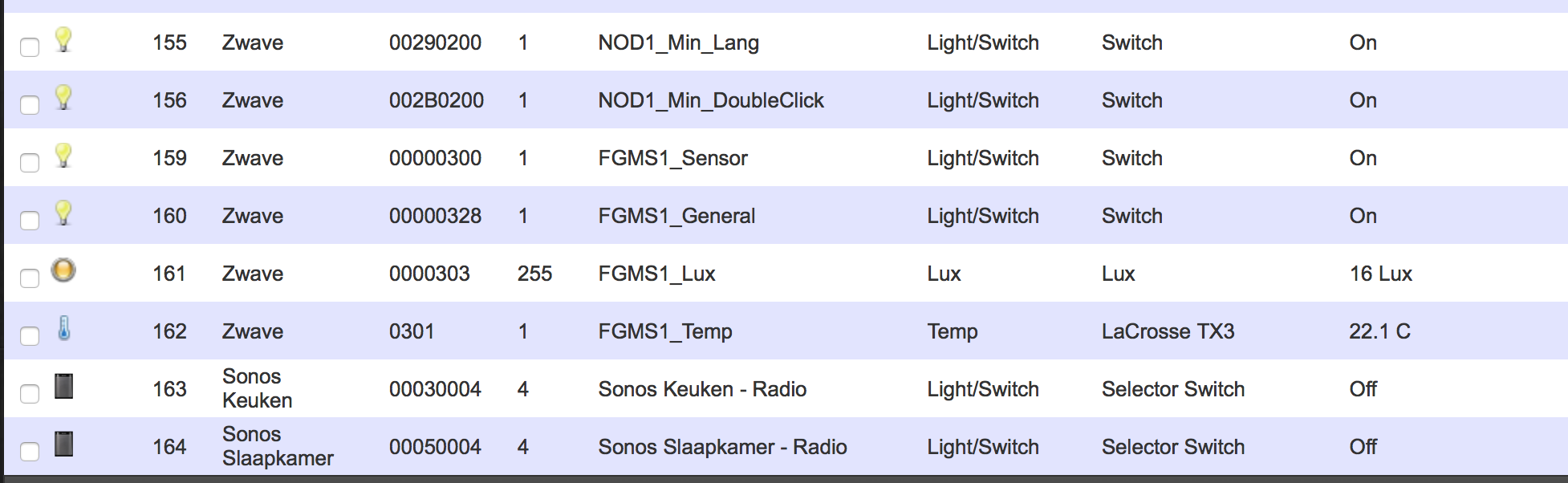

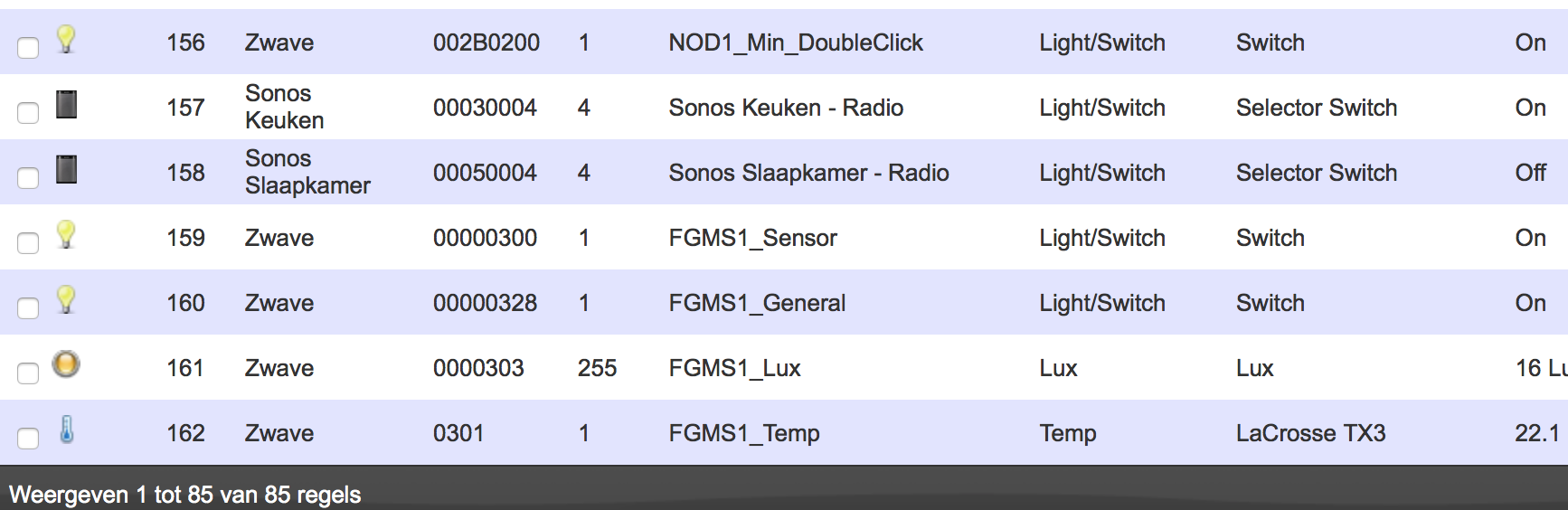

This plugin works great, great work THX, but .......... ;)
I found a weird type of behaviour.
I've changed the setting of SononsKeuken/Slaapkamer of the Refresh radio list from false to true.
This works, but look at the screenshots.
The 2 newly created devices will (after a restart of domoticz) be the last IDX devices.
They started there journey as IDX 15 and 16 and have now IDX 163 and 164 :roll:
For me it's not a problem, but found it a bit weird.
Using RPI3, jessie, Domoticz 3.8153, SonosPlugin 0,91, python2.7.9
R
Schermafbeelding 2018-01-03 om 08.41.15.png (174.47 KiB) Viewed 5460 times
Schermafbeelding 2018-01-03 om 08.40.36.png (160.14 KiB) Viewed 5460 times
G3rard
Posts: 669
Domoticz version: No
Re: Python plugin: Sonos [new version]
Post by G3rard »
@Rodio, thanks for your post.
That indeed happens when you have set 'Refresh radio list:' to True in the Hardware settings.
Then with every restart of the plugin the old devices will be deleted and new ones will be created with the updated radio stations.
So if you set this to False no new devices will be made after a restart.
I have made it like this because that's the only way the list with radio stations can be updated.
