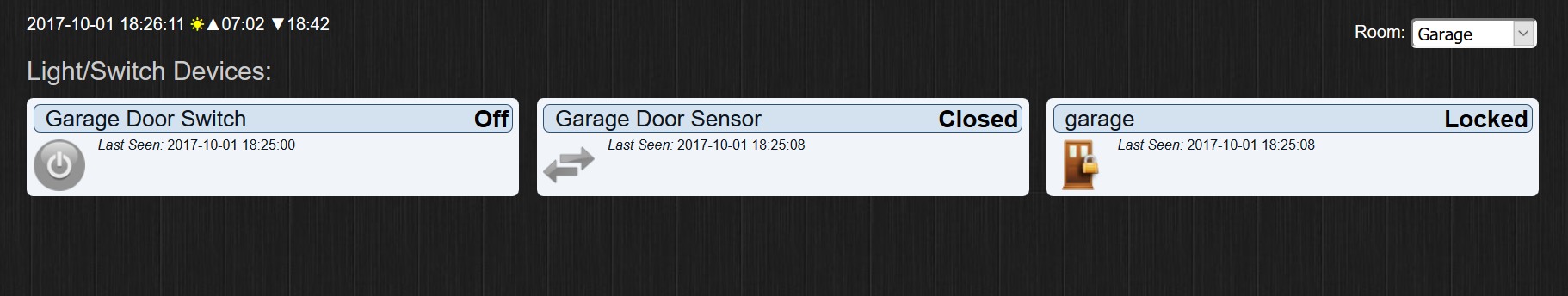

I have created a LUA script to link two switches together. The sub/slave option in Domoticz is limited. This script will link multiple switches together in switch pairs (source and destination). The actions of the source switch will effect the destination. The options are :-
  • Mirror source to Destination
    Toggle source to Destination
    Turn destination on when source is turned on
    Turn destination off when source is turned off
    Mirror Dimmer switches or Sets Dimmer to a set value
    Hide switches
    Update user variables
    Use third switch for conditional Access if true or false switch
The script can either action the switch or simply change the state on the switch in Domoticz. This is useful for resetting switches without triggering the "payload"
The script requires a string user variable to be created called ST-Setting. This variable is then populated with the switch IDx numbers and the commands required. Multiple switches can be added to the user variable to create "ripple effects" . Warning there is only limited syntax checking so creating a switch loop is possible.
The script contains the syntax required to link source and destination switches together
Create a new LUA device event called Switch-Link-1.8 and cut and paste the following

Im having an issue with a garage door contact sensor switch and a door lock switch (virtual) that I am trying to keep in sync. It works 1/2 the time.
Ive made the contact sensor the master (idx 3) and door lock (idx 112) the slave. I want the virtual switch to mirror the state of the contact switch. The virtual switch actually sends a json command to open, which is why I use lower case d. I don't want the switch to trigger, just change its state.
The door itself can be activated via a Domoticz z-wave switch or manually via a remote door opener or via a key for the garage, which causes the virtual switch to go out of sync.
This is my ST-String setting:
3|1|112|d
Here is an example:
To start door is closed. Contact shows closed.
I use the domoticz switch to open. The door opens, the timestamp on all three modify, but the state doesn't match.
here's the log.

If I use the virtual switch to close (open the door). It is temporarily is out of sync, but once the contact sensor reads closed it sets the virtual switch correctly.
once it hits closed on the sensor:

Im thinking there is a natural delay (as the door closes) before it triggers closed but changing from closed to open happens too quickly. I don't know.

2017-11-13 12:53:57.009 dzVents: Debug: Processing device-adapter for garagestate: Switch device adapter
2017-11-13 12:53:57.009 dzVents: Debug: Device-event for: garagestate value: Locked
2017-11-13 12:53:57.009 dzVents: Debug: Searching for scripts for changed item: garagestate
2017-11-13 12:53:57.009 dzVents: Switch Link started
2017-11-13 12:53:57.009 dzVents: Switch Link triggered by garagestate
2017-11-13 12:53:57.009 dzVents: garage Domoticz switch off garagestate On
2017-11-13 12:53:57.009 dzVents: Switch link completed in 0.0010000000038417
2017-11-13 12:53:57.071 EventSystem: Script event triggered: Switch-Link-1.8
2017-11-13 12:53:57.071 (Dummy) Lighting 1 (garagestate)
2017-11-13 12:54:00.173 dzVents: Debug: Dumping domoticz data to C:\Program Files\Domoticz\scripts\dzVents\/domoticzData.lua
2017-11-13 12:54:00.189 dzVents: Debug: Event trigger type: time
2017-11-13 12:54:00.501 User: Admin initiated a switch command (212/garagestate/Off)
2017-11-13 12:54:00.607 dzVents: Debug: Dumping domoticz data to C:\Program Files\Domoticz\scripts\dzVents\/domoticzData.lua
2017-11-13 12:54:00.638 dzVents: Debug: Event trigger type: device
2017-11-13 12:54:00.700 dzVents: Debug: Device-adapter found for garagestate: Switch device adapter
2017-11-13 12:54:00.716 dzVents: Debug: Processing device-adapter for garagestate: Switch device adapter
2017-11-13 12:54:00.716 dzVents: Debug: Device-event for: garagestate value: Unlocked
2017-11-13 12:54:00.716 dzVents: Debug: Searching for scripts for changed item: garagestate
2017-11-13 12:54:00.716 dzVents: Switch Link started
2017-11-13 12:54:00.731 dzVents: Switch Link triggered by garagestate
2017-11-13 12:54:00.731 dzVents: garage Domoticz switch off garagestate On
2017-11-13 12:54:00.731 dzVents: Switch link completed in 0.0019999999931315
2017-11-13 12:54:00.778 EventSystem: Script event triggered: Switch-Link-1.8
2017-11-13 12:54:00.778 (Dummy) Lighting 1 (garagestate)
It says its matching the state but it doesn't.
Here's the state log from idx 112
2017-11-13 12:54:00	Off
2017-11-13 12:53:57	Off
2017-11-13 12:51:24	On
2017-11-13 12:50:56	On
and the log from idx 212
2017-11-13 12:53:56	On
2017-11-13 12:51:24	Off
