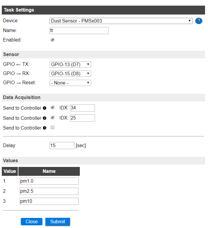

I've got dust sensor PMS5003 connected thru NodeMCU with ESPEasy FW (v2.0.0-dev12).
This dust sensor gives three different values - PM1.0, PM2.5 and PM10 particles.
I would like to add whole three as a one device in Domoticz, unofrtunately now using Custom sensor it gives me only the first value which is PM1.0.
Are you able to prepare new device with three variables for this kind of sensor?
I attached ss from espeasy and below is JSON:

Unit should be [ug / m3]
Are you able to provide such type of sensor or guide me how to extract the data to Domoticz?
