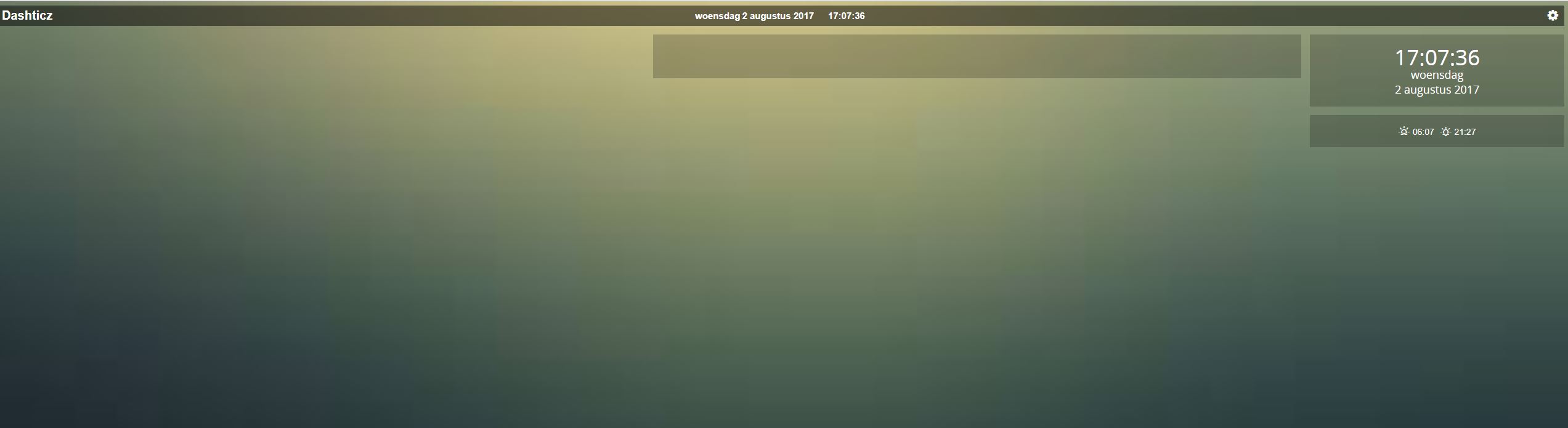

Guys,
some advice please.
Got dashtics up and running.
But every change I make to the config.js will not apply.
It still only sees the default screen.
Any suggestions?
cheers,
Aaron
some advice please.
Any suggestions?
cheers,
Aaron
- screenshot dashtics.jpg (65.83 KiB) Viewed 8235 times
- CONFIG.js
- (3.49 KiB) Downloaded 280 times
robgeerts
- Posts: 1273
- Joined: Saturday 24 January 2015 22:12
- Domoticz version: 3.7067
Re: Dashticz - Alternative Dashboard
Do you use the regular (master) version or the beta?
If you use the original version, try the CONFIG.JS I've added as an attachment first..
- CONFIG.js
- (1.72 KiB) Downloaded 548 times
I had something similar yesterday when setup up my first dashboard.
You forgot to initialize the columns object:
var columns = {}
It kinda sucks that you don't see any error message in the console when you make syntax errors in the configuration. I remember while debbuging the exception was catched somewhere in jquery code and failing silently.
var columns = {}
robgeerts
- Posts: 1273
The erros were catched, but not in latest versions.
Although, he als missed the quotes around the domoticz-path...
avantwist
- Posts: 12
- Joined: Wednesday 21 September 2016 21:51
It works Rob.robgeerts wrote:Do you use the regular (master) version or the beta?
Thanks for your assistance.

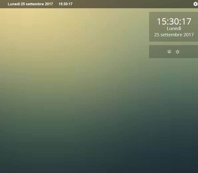

Hi to all,
from internal of network all work fine but from external the page prompt only name and date/time like in picture
