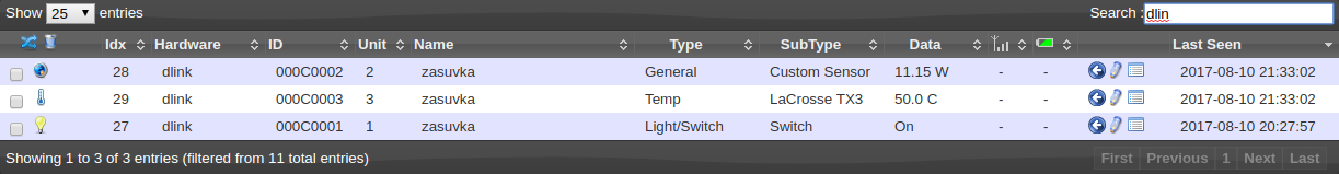

I can read a Temp values :-) in testing.
w215 - switch power temp

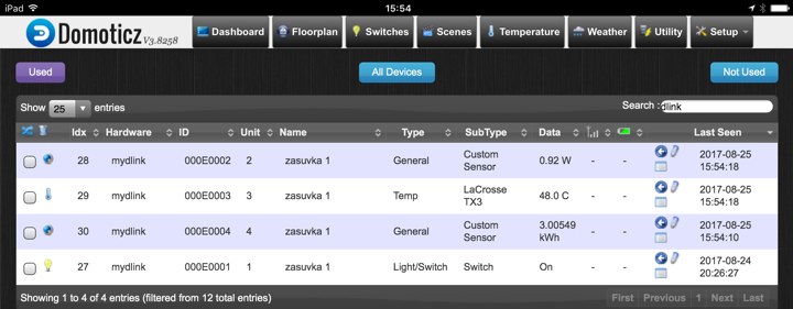

Small preview with temp and kWh, still testing :-)
For kWh I used a custom sensor, I dont know how exactly used a defined 'kWh' device :-)
