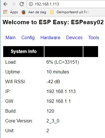

I can connect with browser to mysensor node:

Topic can be closed...i forgot to update the gatewayESP8266 sketch with the router information. I totally forgot this sketch, i though flashing the nodeMCU was enough
