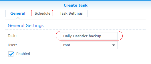

  • 1. Go to Control Panel > Task Scheduler and click on Create > Scheduled task > User-defined script.
  • 2. In the window that opens, give your task a name (on my system the user is default set on "root" and "enabled" is ticked). And then click on "Schedule".

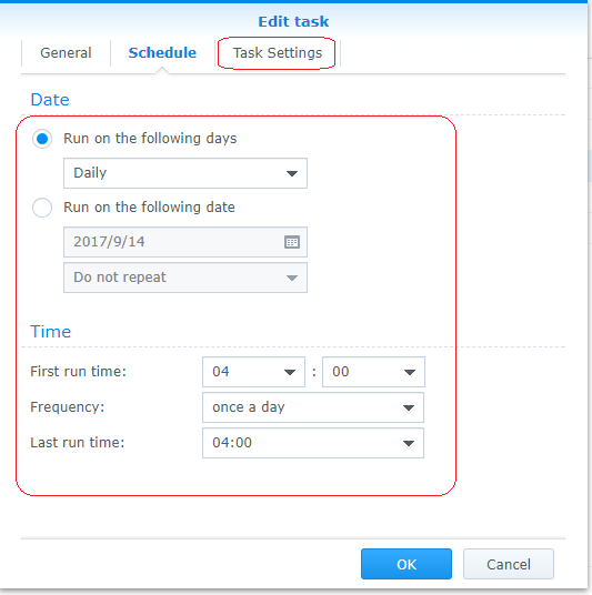

  • 3. At the "Schedule" tab, choose the settings that you like. In the example below it backs up every day at 04:00. Then click on the "Task settings" tab.

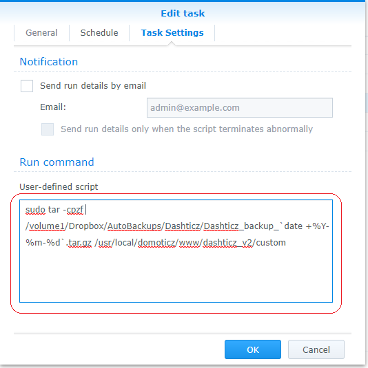

  • 4. At the "Task settings" tab, paste the following code in the "user-defined script" box.
    sudo tar -cpzf /backup/destination/path/Dashticz_backup_`date +%Y-%m-%d`.tar.gz /source/path/domoticz/www/dashticz_v2/custom
    For example, in my case, I'm using:
    sudo tar -cpzf /volume1/Dropbox/AutoBackups/Dashticz/Dashticz_backup_`date +%Y-%m-%d`.tar.gz /usr/local/domoticz/www/dashticz_v2/custom
    This code creates a compressed file with filename "Dashticz_backup_2017-09-14.tar.gz" (date is automatically changed) with the contents of the "custom" folder of Dashticz, it then places it in my destination folder which in my case is a folder I sync with dropbox to have an offsite backup of the files, but you can place it in any folder really. Please note that the source path is not the same for everybody as Domoticz is installed in the folder of a user on your NAS, so check where Domoticz is installed on your NAS.
