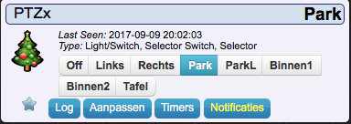

The PTZx selector is defined as :
(http commands are : [http://] 10.0.111.101/cgi-bin/CGIProxy.fcgi?cmd=ptzGotoPresetPoint&name=[name of FI9826P preset point]&usr=XXX&pwd=YYY)
You have to define and name the preset points in the Foscam camera webpage (which in my case is on local IP 10.0.111.101).

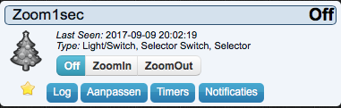

Zoom1sec selector is set up as a 1 sec delayed-off switch.
[http://] 10.0.111.101/cgi-bin/CGIProxy.fcgi?cmd=zoomStop&usr=XXX&pwd=YYY
[http://] 10.0.111.101/cgi-bin/CGIProxy.fcgi?cmd=zoomIn&usr=XXX&pwd=YYY
[http://] 10.0.111.101/cgi-bin/CGIProxy.fcgi?cmd=zoomOut&usr=XXX&pwd=YYY

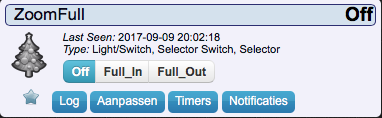

It takes about 4secs to zoom In or Out completely, so in ZoomFull the delay-off time is set to 5 secs. Note that Zooming is not stored in preset points (only Pan and Tilt positions can be stored and recalled).
