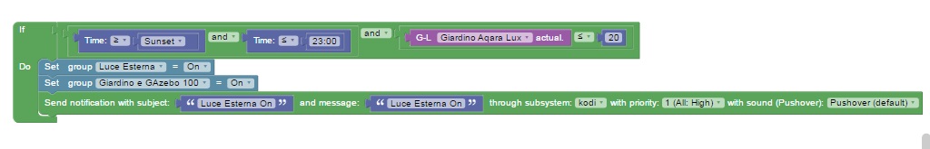

this is my scenario
light open between sunset and 23.00 and if sensor lux xiaomi is under 20
only notification in kodi not work

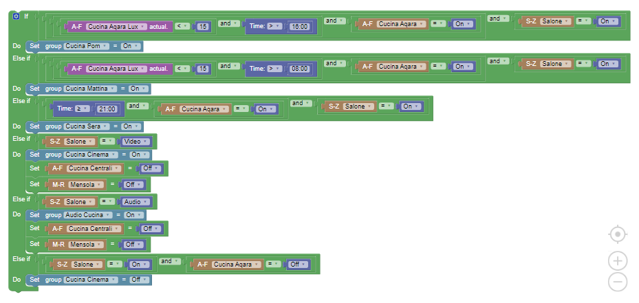

this is mine for living room.
only a question is it possible add the set group .... after (3) minute ?

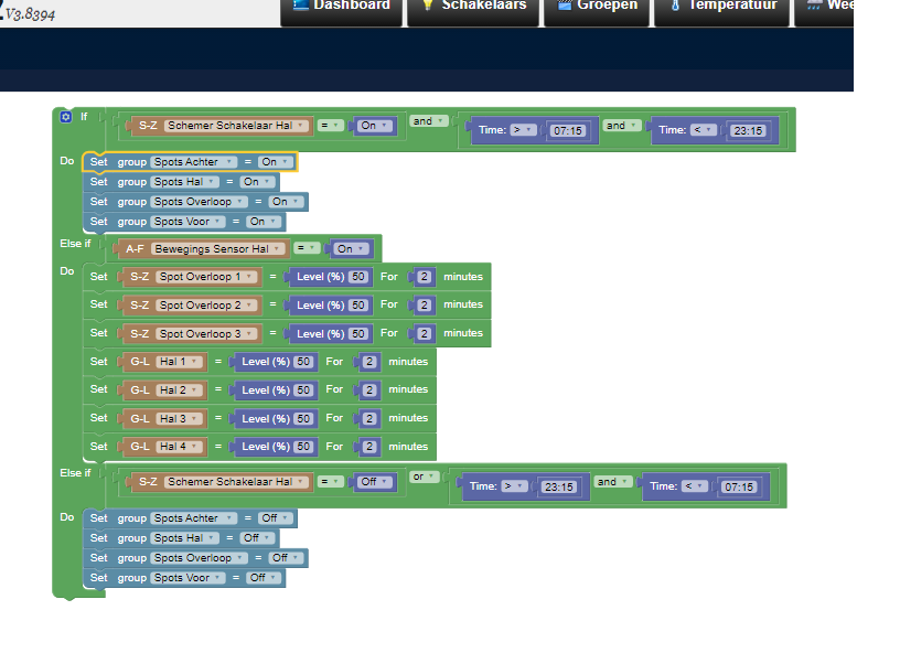

Just build a small blocky script to turn on my lights when it gets dark, use philips Hue motion/dusk sensor.
First line is to switch lights on with the group setting when dusk sensor goes on and time is after 07:15 and before 23:15
second event is when the motion sensor detects motion to let lights in Hal and overloop burn at 50% for 2 minutes, could not use group so did it per light.
Third event is to switch lights of when dusk sensor is of or time is after 23:15 before 07:15.
Script seems to work but issue is that when motion is detected lights go to 50% but only for 30 to 45 seconds it varies when I messured.
Attached my blocky script. I most likely make an error in my reasoning with the script. help appreciated

Not sure if this will solve the timing problem, but your time period on the last "Else If" should be:-Benneton wrote:Hi,
"after 23:15 OR before 07:15".
This is because Domoticz changes to the next day at 00:00. So the time can't be:-
"after 23:15 (and before 00:00) AND (after 00:00 and) before 07:15.
Apologies if this does not fix the problem but worth a try?

Hi StanHD,Not sure if this will solve the timing problem, but your time period on the last "Else If" should be:-
Apologies if this does not fix the problem but worth a try?![]()
Thanks for the support. Did change the last one to "or", but then for some reason when motion is detected nothing happens.
So I did set this back to "and".
Today I also noticed (could not try yesterday) is that when Dusk sensor is of and motion is detected light will go to 50%, but only for approx. 10 to 15 seconds.
My reasoning is that it is a human interface error and that my logic in thinking is incorrect.
Is there someone out here who has the timer function working correctly i.e. if event happens set light to 50% for x amount of time?
Bernard

Benneton wrote: Thursday 14 September 2017 8:51Hi StanHD,Not sure if this will solve the timing problem, but your time period on the last "Else If" should be:-
Bernard
i have the same problem with the HUE bulbs.
Set the lights on with "set level 50% and, set lamp off after 120 seconds. resolved the problem for me.
Maybe it wil work for you/
