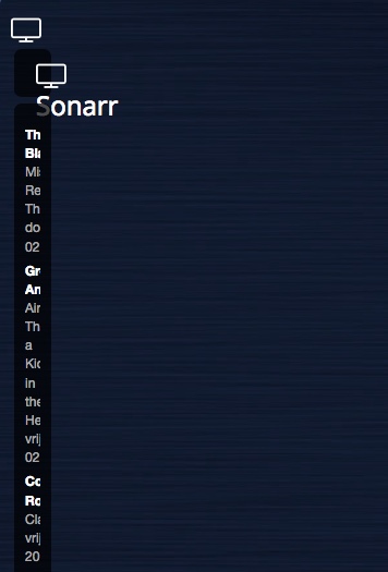

I'm getting a weird display of a small bar on the left which I think contains the items after pulling the last beta.
I've tried to rule out the blocks definition first in CONFIG.js to let it show as default, no joy.
Or do I need to remove anything I've set previously in custom.css ?
Cheers,
Ray

Luxtux
Posts: 31
Joined: Monday 14 August 2017 15:16
Domoticz version: 2021.1 β
Location: Luxembourg
Re: Dashticz - Module - Sonarr
Post by Luxtux »
Thank you. I hadn't installed the latest beta yet. I found the error and corrected it. Ive initiated a pull request on github. So when Rob accepts the change the problem should be solved.
have a nice day
