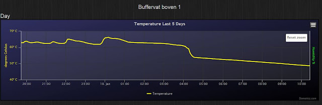

Serial debug output looking good:
Still need a bit of bit-shifting or masking regarding the temp values because sometimes the value is reported as negative, which should not happen.
I also used the floorplan option in Domoticz to show the diagram of my system:

I solved the issues I had with incorrect temperature values.
Everything looks fine now.
There were also a number of gaps in the reporting, they appear to be solved too.
The code needs a bit of cleanup, additional commenting and removal of my IP's and IDX'es before I can publish it.
This is my temporary setup:
