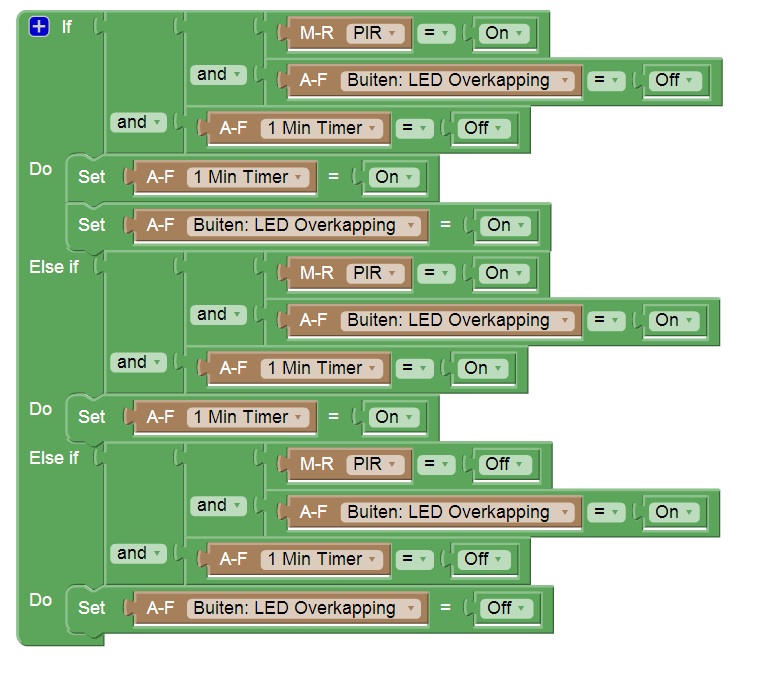

It's possible with blocky. Just add another (dummy) switch witch will switch off after 1 minute (it's a setting of the switch) and call it for example 1 Min Timer (in my example)
(sorry for the big image, my tablet has a high dpi setting)
Every time the PIR detects motion the timer will be activated again and starts counting down from 60 seconds. Until the last movement is detected, then the light will go off.'
You can do a lot of nice stuff with blocky, just think a little further than the standard blocks ;)

It appears that "dummy" switches are treated differently to "physical" switches, as you are relying on switching your "1 minute timer on" while it is already on, which is inconsistent with not being able to skip the dummy switch and just do it for the light with 1 minute to off and multiple ons - :shock:
Or am I missing something obvious :oops:

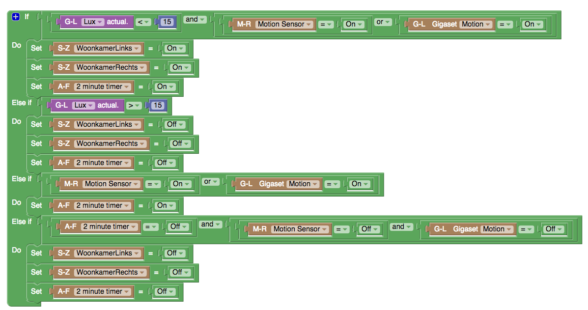

So with the blocky below the lights turn on when the amount of lux < 15 and motion is detected on one of the motion sensors (works). The 2 minute timer has a 120 sec delay on 'off' and even though a new motion is detected and the '2 minute timer' switch gets updated, all lights still turn off after the initial 120 seconds.
Any suggestions/ideas?

try to remove the 3 event.

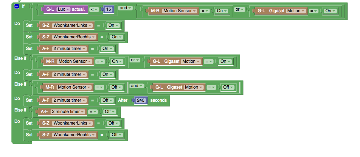

Got it to work!
Schermafbeelding 2016-06-26 om 22.44.37.png (120.8 KiB) Viewed 13413 times

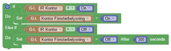

Hi.
This simple Blockly code is working
Domoticz Motion.JPG (25.04 KiB) Viewed 12628 times

bizziebis wrote: Friday 18 April 2014 18:25 It's possible with blocky. Just add another (dummy) switch witch will switch off after 1 minute (it's a setting of the switch) and call it for example 1 Min Timer (in my example)
Sorry to revive an old topic, but using this method every time the timer is set to on, it will detect the second blockly row, see that the timer is set on, and set it on again:
