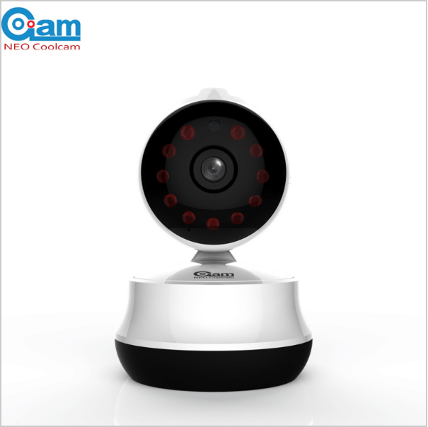

I bought a cheap ip cam from china and i can't get it to work with Domoticz, does someone know how i can add this ipcam into Domoticz.
Its a NEO COOLCAM NIP-61GE mini. I already tried some links from this site with no luck.
