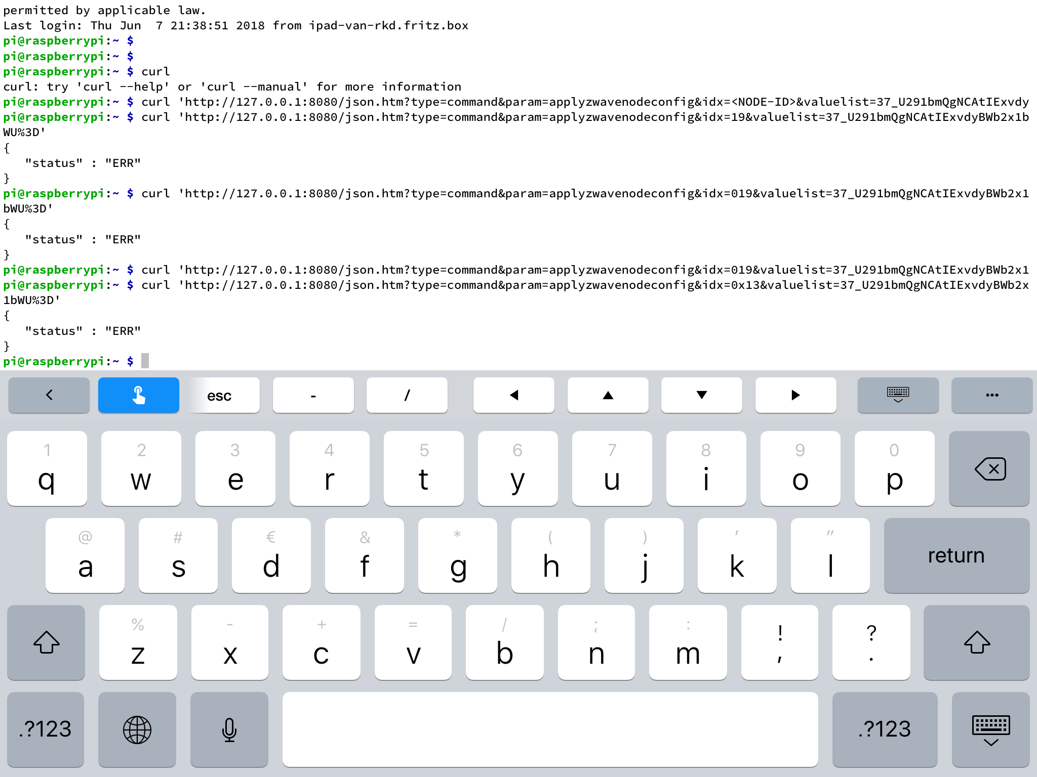

Ries
Posts: 40
Joined: Tuesday 01 December 2015 8:47
Domoticz version: 2022.1
Re: Aeotec Siren Gen5 parameters
Post by Ries »
Still no result

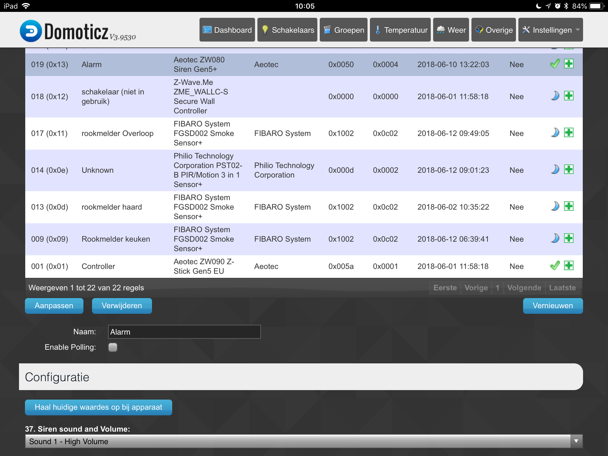

Ries
Posts: 40
Post by Ries »
I solved it on my part
The idx of the siren in domoticz = 1
The idx of the zwave node is 019/0x13
It worked when I used idx = 7
I found it by using the chrome developement tool, when changing a parameter (network tab, shows the json url when hitting “pas configuratie toe” in de openzwave tab
