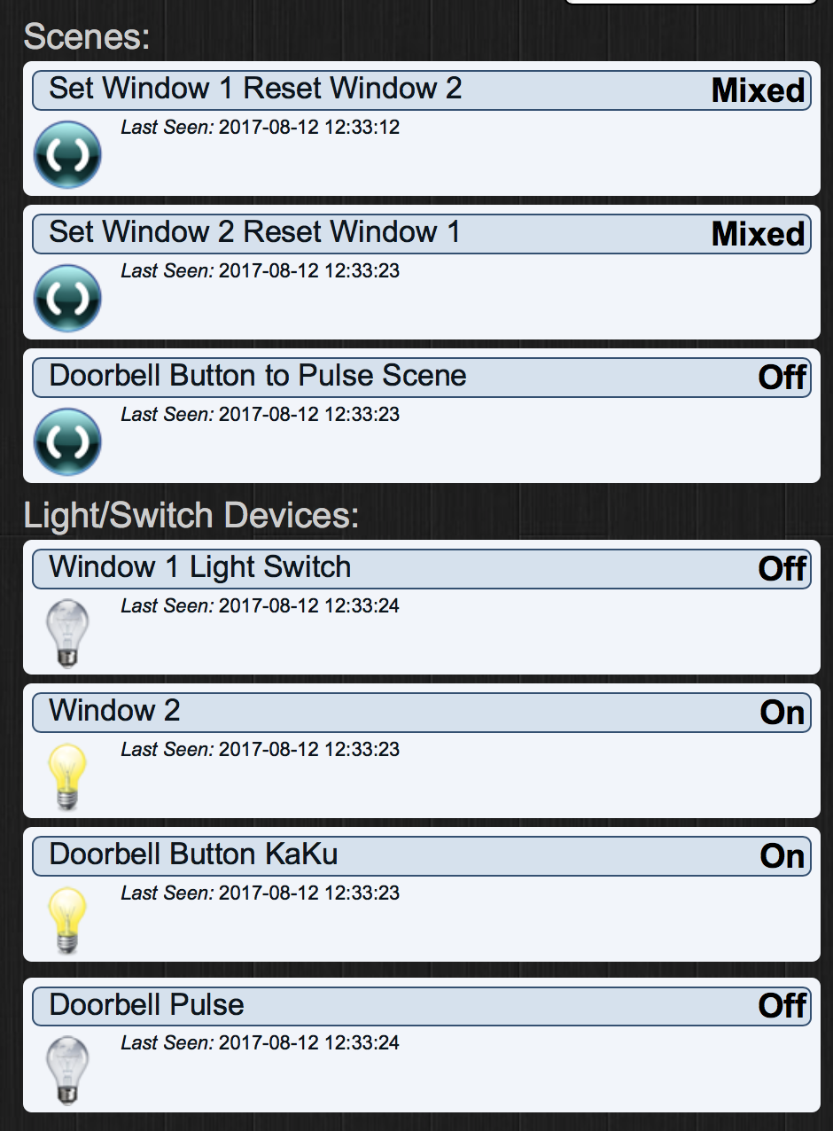

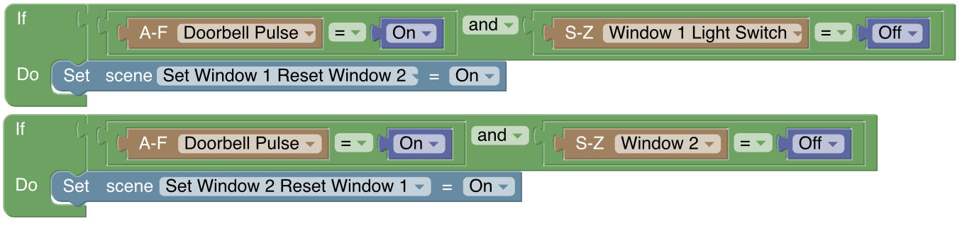

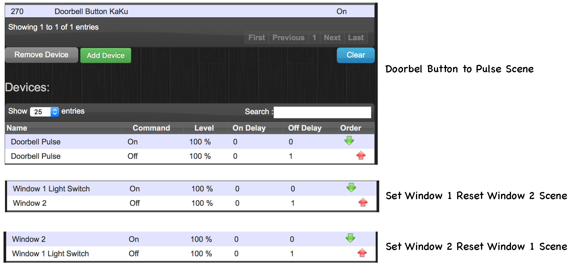

To control my garden lights with a KlikaanKlikuit (KaKu) doorbell button I wanted to use Blocky.
After some experimenting I ended up with 4 Switches, 3 scenes and 2 events to realise this function. My solution is not very elegant, but Blocky's restrictions forced me to choose this way.
Please note that the 1 second Off delays are required!
Screenshot 2017-08-15 10.30.20.png (321.17 KiB) Viewed 7236 times
