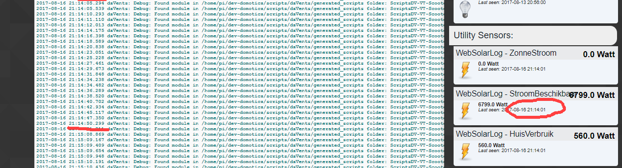

script is now, with IDX in place, looking like this;
	active = true,
	on = {devices = {82153}},
			domoticz.email('Energy trigger!!')
			domoticz.notify('Energy trigger!!')
No notifications and/or email and here's the logscreen and device with its last trigger time;
Screenshot - 16_08_2017 , 21_15_48.png (103.04 KiB) Viewed 4605 times
(the red oval should be one device lower)

Is that the id of the device??? Check the idx column of the device list in domoticz. Never seen such a high number.

Freemann wrote: Thursday 17 August 2017 11:44 So, every time Domoticz starts dzVents ánd debug logging is enabled you should see these lines:
dzVents version: x.y.z
Event trigger type: xxxx
Yes I See (see code snippet)
2017-08-17 11:40:45.930 dzVents: Debug: Device-adapter found for Warmtepomp(kWh): kWh device adapter
2017-08-17 11:40:45.941 dzVents: Debug: Processing device-adapter for Warmtepomp(kWh): kWh device adapter
2017-08-17 11:40:45.941 dzVents: Debug: Device-event for: Warmtepomp(kWh) value: 0.000;147980.000
2017-08-17 11:40:45.941 dzVents: Debug: Searching for scripts for changed item: Warmtepomp(kWh)
This confuses me. In your Domoticz version you should see something like this every time dzVents starts processing: Event trigger type: ... I don't see that here. And... Warmtepomp? I was expecting to see 'WebSolarLog - HuisVerbruik'.
What did you do exactly to trigger this event (if it would work)?
Freemann
Posts: 94
Joined: Thursday 24 November 2016 14:55
Domoticz version: >=Béta
Re: Trigger on "Dummy/Usage/Electric" device
Post by Freemann »
This was just a random set of lines, because I don't see the 'WebSolarLog - HuisVerbruik' coming by.

Ok, but I'm more interesting in what you do that should cause the 'WebSolarLog - HuisVerbruik' script to be executed.

Yes, I see this.. we are exploring this and see if we can fix this. Thing is that perhaps people in some situation don't expect the event system to be triggered when sending in UpdateDevice command.
Freemann
Posts: 94
Post by Freemann »
What do you need from me to help debug this further?
