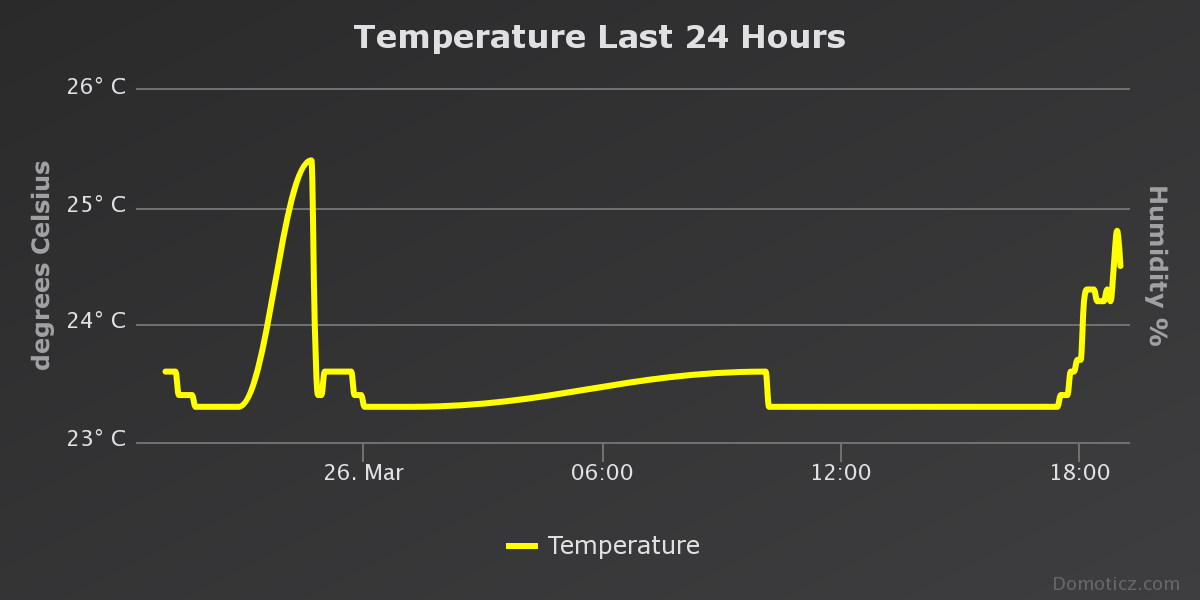

This is strange... The device has not been seen by Domoticz since 22:09 yesterday evening, the time when I last posted. I left it at the exact same physical location as it was when the temp was received, but it hasn't been received since. First I was wondering if it's that it only sends the temperature information when it changes, but now that I've been watching the device and the temperature changing on the screen, there's nothing on Domoticz even though the temperature changes.
...any ideas?
...any ideas?
Trunald
- Posts: 10
- Joined: Saturday 04 March 2017 11:06
Re: WT0122 Pool Thermometer
I might have solved the mystery. Looking at the behavior and the data received by domoticz, it looks like the temperature sender unit has some sort of a tolerance for the change of temperature before it does send a message. If I make the sender unit temperature a bit warmer, I seem to be receiving the temperature, and when it cools down back to room temperature, the temperature appears at regular intervals until it is room temperature, then it might be hours without new data appearing.
Would be great if someone else that owns a WT0122 device could confirm this is the way it works?
