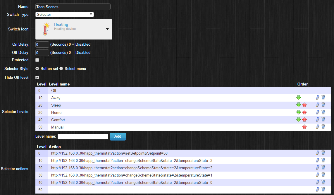

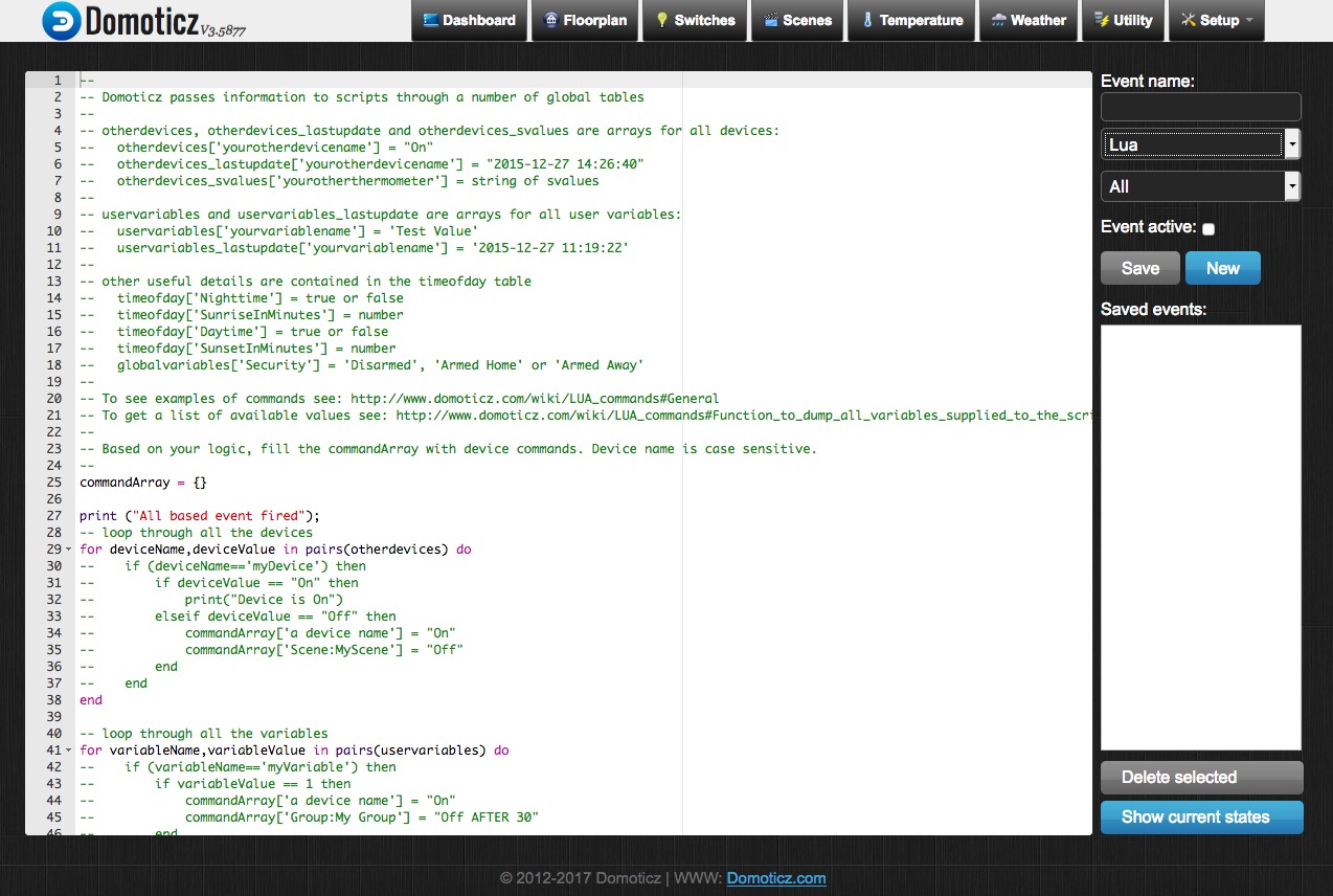

Yes but even this wiki don't tell me where to put the script (and the script is different from the scripts from Maes)
There is already a script on Setup > More Options > Events see picture. So how to put the new scripts in it?
existing script in Domoticz
Schermafbeelding 2017-09-19 om 16.27.43.jpg (262.82 KiB) Viewed 4400 times

That is just an example. Remove it and paste the script from the wiki in it.

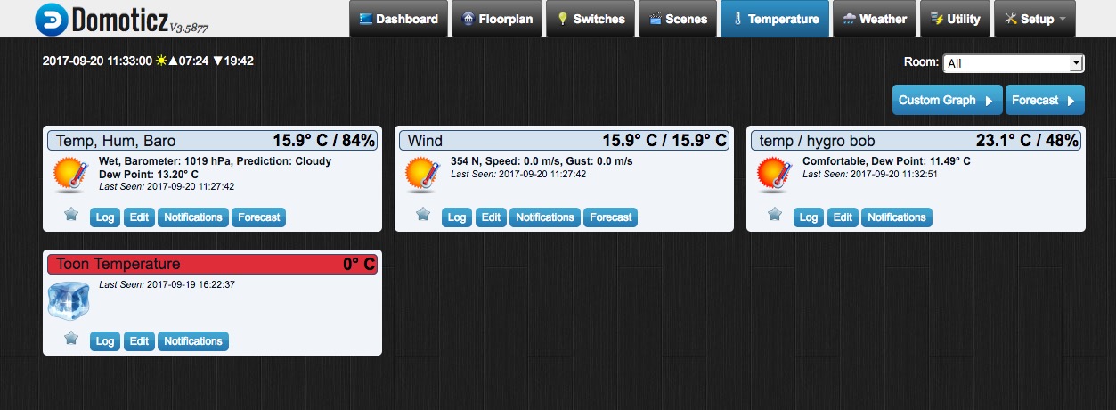

Nothing changed. Toon scripts and Toon auto program should dial functions with http.... directly in Toon but too bad nothing happens.
Sensors like Toon Temperature and utils like toon thermostat should use script, but i can not call any script from these dummies.

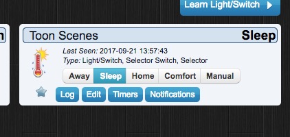

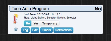

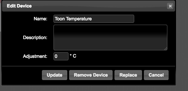

Now i got a temperature on Toon temperature also no error But when i go to Toon Scenes and change the setting from home (thats the setting on de day normal so now) to by example away or sleep, it change after a few seconds to home.
Also on the ToonThermostaat script
Error: EventSystem: in ToonThermostaat: [string "-- Script used for Toon Thermostaat utility d..."]:8: bad argument #1 to 'pairs' (table expected, got nil)
And when i push on the flame at dummy Toon Thermostat, i got 2 arrows but after a few seconds after changing setpoint the setpoint is back on the original temperature.
So finally only the temperature sensor is really working the event switches and the thermostat ar reset after a few seconds.
