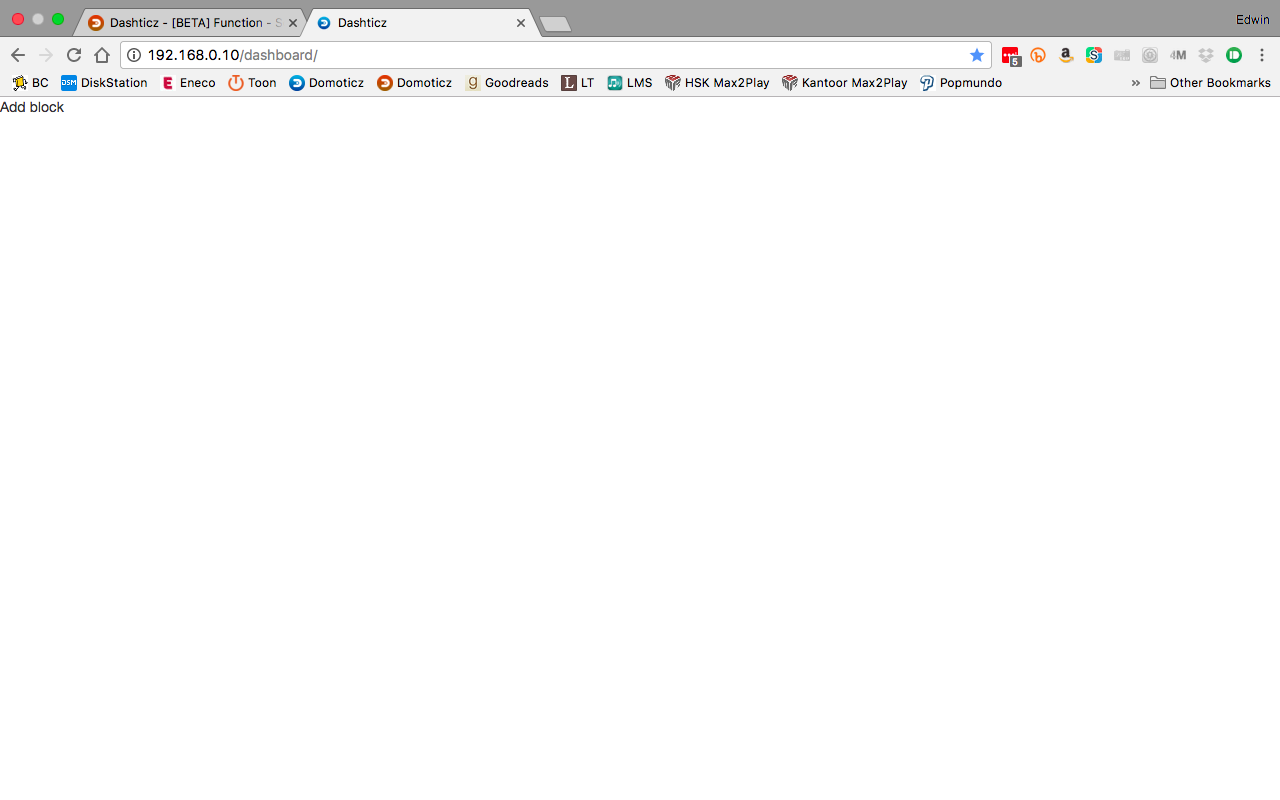

Right before Dashticz starts, I see a text 'Add block' in the upper-left corner of the screen.
This is what I see before Dashticz loads
Screen Shot 2017-08-10 at 22.14.04.png (66.41 KiB) Viewed 3086 times

Latest version the add block on load is gone.
