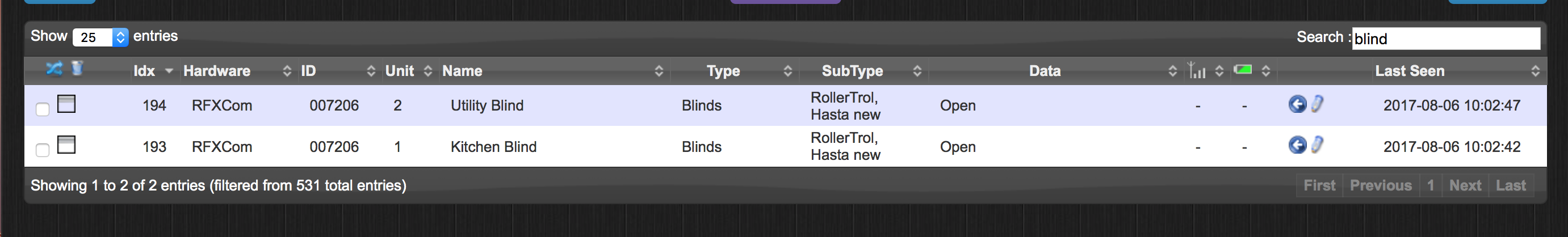

I am having the same problem with my blinds after updating. If I click on them it says "opening" or "closing" but doesn't nothing. Even timers do not work and none of it appear in the log.

I suppose something has changed in the Unit Code.
Please check with RFXmngr if the motor can be controlled using the same ID and Unit code or maybe a different Unit code.

I have tried to learn a new code from the blind remote and its not recognised by domoticz. Very Strange..b_weijenberg wrote:I suppose something has changed in the Unit Code.
