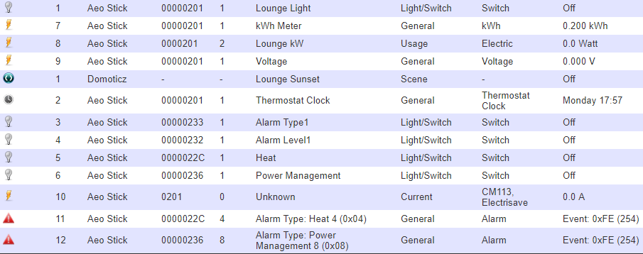

I have an Aeotec Nano Dimmer connected and working nicely with a clipsal bell press switch connected to S1. S2 is not connected to anything.
In the config for the Nano I see that the switches S1 and S2 can be configured to power the load and or other nodes. From this setting I presume I can access the status of S1 and S2 and link events to them in Domoticz.
But S1 and S2 don't appear in the list of devices as I imagined they would.
How can I link events to S1 and S2?

After hours of trying to solve this puzzle, I have discovered that S1 signals "Group 3" and S2 signals "Group 4".
How can I receive the events sent to these Z-Wave groups in Domoticz? Is it possible?

I got it - just add as an Activation Device to a Scene.
