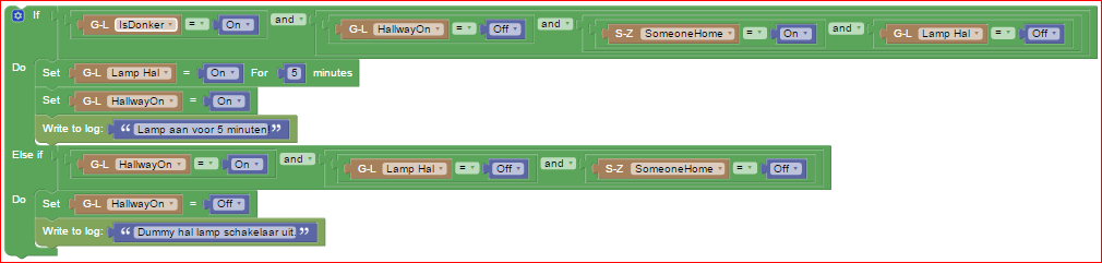

I'm having some issue with a blockly which does a bit more than needed. Situation is, I've got a dummy which tells if it's dark or not (IsDonker) and a dummy which tells if someone's home (SomeoneHome).
What I want to accomplish is the hallway light turning on for 5 minutes when it's dark and someone comes home. This blockly does exactly that, but it also turns the light on for 5 minutes when someone is home and it gets dark. I only want it to trigger on someone coming home in the dark, not when we're already at home. I'm starting to get the feeling I can only do that in a script since blockly triggers on all device changes.
So, can it be done in blockly? Or should I really brush up my LUA knowledge?

what's the difference between 'HallwayOn' and 'Lamp Halway'. One being a group of Lights?
edit:
and how do you know someone is coming home?
dizzyweb
Posts: 20
Joined: Tuesday 20 June 2017 13:46
Domoticz version: 4.10007
Re: Blockly examples
Post by dizzyweb »
HallwayOn is a dummy switch to register if the light has been turned on before. Else the lights would just go off and on again after 5 minutes, since the conditions haven't changed. Lamp Hal is the fibaro switch that switches the physical lamp.
SomeoneHome is a dummy switch that is turned on when either my phone or my girlfriends phone is online on our wifi network. Using the presence detection script from the wiki.

I'm not sure the Lamp Hallway switch would go on again, if you wouldn't use that HallwayOn dummy switch.
You enter the home, the SomeoneHome dummy switch changes from Off to On. That triggers the action.
Have you tried a simple
If SomeoneHome = On and IsDonker = On
set LampHal = On for 5 Minutes
In my experience "If SomeoneHome = On" doesn't mean what it says (always check if someone is home and if so, do what is stated) but it means once the status of SomeoneHome switches to On, do what is stated. I might be wrong, but give it a try.
Of course i don't know how often SomeoneHome switches during the night for other reasons (system changes, phones go off, etc)... if that's the case you'd have to work with a dummy switch somehow.

ok, i forgot this will turn on once it gets dark and someone is home. so you need a dummy switch. sorry. this was your original problem.
try
If SomeoneHome = Off and IsDonker = On
Set HallwayOn = On
Else If IsDonker = Off
set HallwayOn = Off
Else If SomeoneHome = On and HallwayOn = On
dizzyweb

That might tackle my current problem, but... doesn't this mean my light will never turn off again? After 5 minutes those conditions will still be true, so the light will immediately turn on again. I think I'd need yet another switch for this...
four2six
Posts: 53
Joined: Wednesday 24 February 2016 9:16
Location: NRW, Germany
Post by four2six »
i don't think this will turn the light back on. as i said above, it doesn't check both if-parts for being true, but it checks if the whole if-block turns (!) true. as long as you don't leave home and SomeoneHome is turned to off and you enter your home again and SomeoneHome turns back to On, the light shouldn't switch on. And this seems to be exactly what you want. Give it a try.

Post by dizzyweb »
Hmm, you're right. I wonder why the light kept turning back on yesterday. <ight have to rename the dummy though, it's functionality isn't really matching it's use like this :P

Well, I'll leave it as is for the moment since... it still turns the hallway lights on at sundown when we're already home. So your suggestion seems to have the exact same outcome as my own blockly :P
Thought I really don't understand why it happened yet.
Edit:
Figured it out. Had an error in the first if [SomeoneHome = On] instead of Off. But it wouldn't work if I tested it after I corrected the error... But I figure that's because the 5 minutes for the previous trigger hadn't run out. It seems you can't trigger that event again during the "for X minutes" cycle. I'll have to wait till tonight for a live test, but it appears to work.

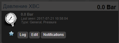

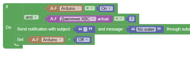

I've got pressure sensors like this one:
And I can't get such event working:
I have also tried using String field for pressure value.
Works only "not equal" type.

some first thoughts: why is the notification subject empty?
did you try it without the notification?
is the value of the pressure sensor above 1 and then changes to below 1? or is it below 1 all the time?
sisaenkov
Posts: 50
Joined: Friday 27 May 2016 7:21
Domoticz version: 3.8
Location: Moscow, Russia
Post by sisaenkov »
1. Subject is unnecessary for Telegram notifications.
2. Yes, I tried.
3. At that moment value of pressure sensor was 0.
Unfortunately blocky doesn't work correctly with pressure sensors' value.
As a result I decide to write this logic with LUA:
if (otherdevices['ColdWaterAvail'] == "On" and otherdevices_svalues['CWPressureSensor'] <= "0.5") then
    commandArray['ColdWaterAvail'] = 'Off'
    print('CW Pressure is: ' ..otherdevices_svalues['CWPressureSensor'])
four2six
Posts: 53
Post by four2six »
blockly has a problem, if both 'and' conditions are already fulfilled. i'd guess it would work if one of them becomes true after you start the testing. LUA is definitely safer.
