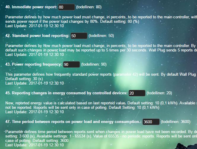

Note: the diswasher (tiskikone) is idle here, no load (ok well, it sometimes goes to 0.3W).
What is also strange, I took away the switch form the wall and these update messages still kept coming until I restarted Domoticz. Also my latest attempt to exclude/include was not successful anymore as nothing happened - so I went ahead and hard reseted the plug. When including as a new device, it first seemed to be ok but quite soon this behaviour started again.
This particular plug is z-wave+, Domoticz (latest beta) sees it with exact same parameters as the non-+ Fibaro plugs. Can this mean something, should it be recognised in some other way than the "old" plugs (they are bought around the same time though)?
For some reason the problems with the z-wave devices escalated when I added an RFLink. Power Supply is original 2.5A RPi adapter so I guess it should be ok. I have only added a couple of RFLink switches so far. There's been strange behaviour with these time to time but everything has still worked pretty smoothly. Now the situation is worse in a long long time and Domoticz is often quite unresponsive and thus Monit also keeps restarting it at least a few times a day. Maybe coinsidence but nothing this severe was happening when there was no RFLink (and biggest problems went away when I took it out for a week or so). Still, RFLink itself seems to be working well and all problems (= too frequent updates) seem to be happening with z-wave. Controller is Aeoteck Gen5 usb stick.
Any ideas would be welcome :)

You give a lot of words but not many facts.
The minimum is that you mention the type of the Fibaro wall plug.
Then ... make a snapshot of the Fibaro configuration.
The Fibaro FGWPE has f.i.:
parameter 40, 42, 43, 45 and 47 that are involved in power measurement and/or reporting.
How do these parameters compare to your other Fibaro's (from unknown type)?
Did you try to remove the particular Fibaro from your zwcfg_0x.......xml cache file ?
- Dis-able your Z-Wave controller
- edit the zwcfg_0x.......xml cache file
- remove the concerned node section
- Enable your Z-Wave controller
Domoticz will fill the cache file with fresh info for that node.

The parameters involved in power measurement and/or reporting were first at default (when I took the plugs into use). I've increased them (for all plugs) as problems have emerged. The plug in question currently has these values:
There does not seem to be any noticeable effect when changing the values. But for example if I set parameter 1 active (always on), I cannot turn it off anymore so in that sense the settings seem to work.
The last bit (removing from cache file) I have not tried yet but I can test it later today.

Could it be that your diswasher (tiskikone) is sleeping/waking and power consumption goes from, say 0.1 Watt to 0.3 Watt
and reports that (5 times per 30 seconds ) because of parameter 42 (change bigger than 50%) ?

Domosapiens wrote:Could it be that your diswasher (tiskikone) is sleeping/waking and power consumption goes from, say 0.1 Watt to 0.3 Watt
Just beat you to this conclusion :) Guess it means it does not even help to have the correct xml if the dishwasher itself is causing this. It would be nice if there was also a absolute wattage parameter so that you could e.g. define not to report changes smaller than 1W...

- Stop Z-Wave
- edit the zwcfg_0x.......xml cache file, remove the concerned node section
- Start Z-Wave
- check if it's recognized according to the manufacturer_specific.xml file:
<Product type="0602" id="1001" name="FGWPF Wall Plug Gen5" config="fibaro/fgwpfzw5.xml" />
- check if the configuration options are different compared to the non-Zwave+ version
https://github.com/domoticz/domoticz/co ... 30436bf589
- Fiddle with Parameters 11 up to 14
