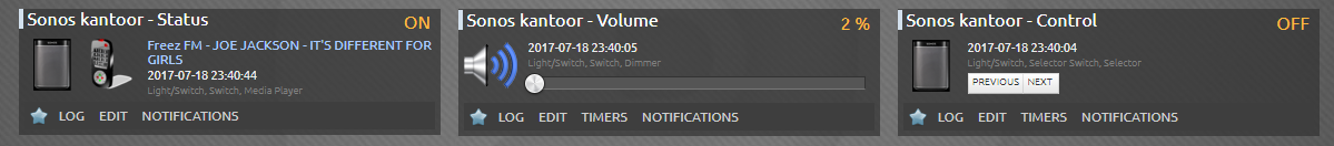

Unfortunately tester22 is no longer maintaining the code for this plugin.
But I agreed with him that I will continue developing and maintaining the code for the Sonos plugin.
I am currently working on a new version which also shows the radio station and the volume again and has an option to go to the previous or next song. Will see if I can add some more options to the Control switch. Any ideas are welcome.
Next to that I will also have a look if I can load the favorites so they (at least the first 10 due to the limit of the items in the selector switch) can be operated from Domoticz.
When I have the new version ready for testing, I will post that here.

Hey Gerard,
That looks pretty cool. I had to switch back from Beta to Stable so for now don't have any native SOnos control from Domoticz, but I'm using jishi's node script, which works pretty good for now.
Would it be possible to build something similar to how his 'clipall' command works, as a native Notification in Domoticz?
https://github.com/jishi/node-sonos-http-api

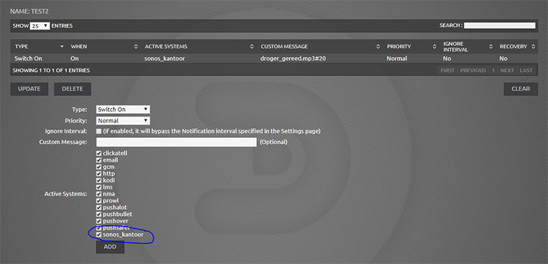

The test version of the new plugin is nearly ready.
It will have on option to play a file on the Sonos via the notification system in Domoticz :D
That way a file can be played from any other switch or LUA by sending it as a notification to the Sonos.
The Sonos will then play that file and after that continue playing the song (on the same position) or radio station it was playing before the notification.
I aim to have the test version ready this weekend so you can also try it yourself.

This looks brilliant! Does this single notification get played to all sonos speakers in the system, or is there any control over which ones can be applied?

The notification will get played on the Sonos you choose in the overview with the checkboxes. So if you have for example 2 Sonos, you can both select them and the message will be played on both.
