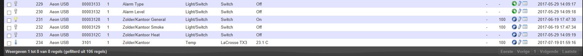

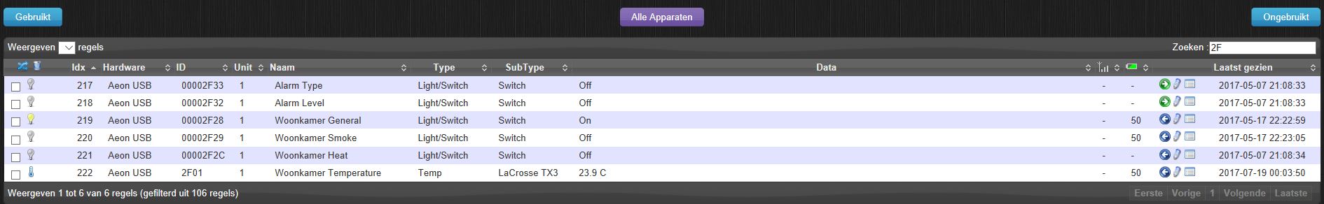

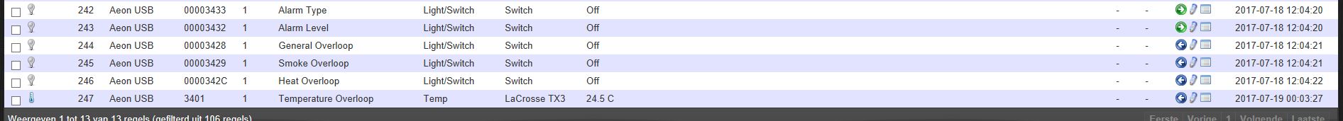

Back to why I started looking at the devices in the first place. Now I have 3 smoke detectors in the network and I am able to get an overview of them:
Smoke 1.JPG (93.72 KiB) Viewed 777 times
Smoke 2.JPG (68.15 KiB) Viewed 777 times
Smoke 3.JPG (64.75 KiB) Viewed 777 times
I have added the third one yesterday. I don't see a battery indication. Is that the same as with a smart plug and indicating kWh? I just need to wait for a while before they get updated?

Sometimes you have to wait some time for update like these
