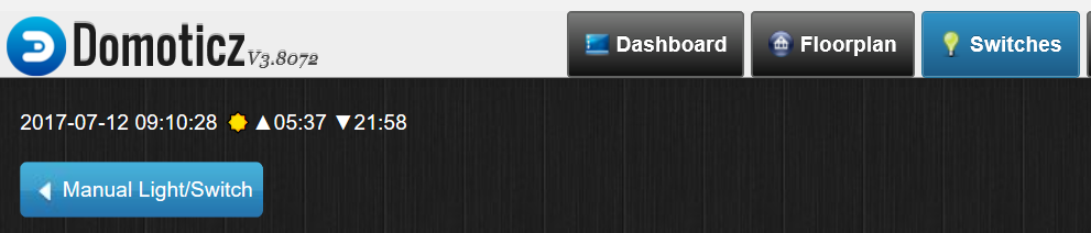

I create Dummy switches in the "Switches" page. On the left there is a button "Manual Light/Switch".
Then I can make my switch:
There is no "Type" dummy, so I picked one. I thought this was the way to create dummy switches. But now I saw I can create a dummy switch from the "Hardware" page.
