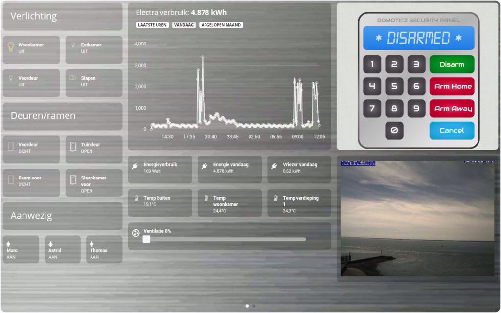

I've been playing with Dasticz last last couple of days (as posted in the General Discussions topic) and had some issues with graphs not being displayed properly. Somehow I managed to fix that, but ran into a different issue with blocks being displayed within the graph after selecting the 'laatste uren' or 'afgelopen maand' view. See screenshots below.
This is the dash I have when opening the page:

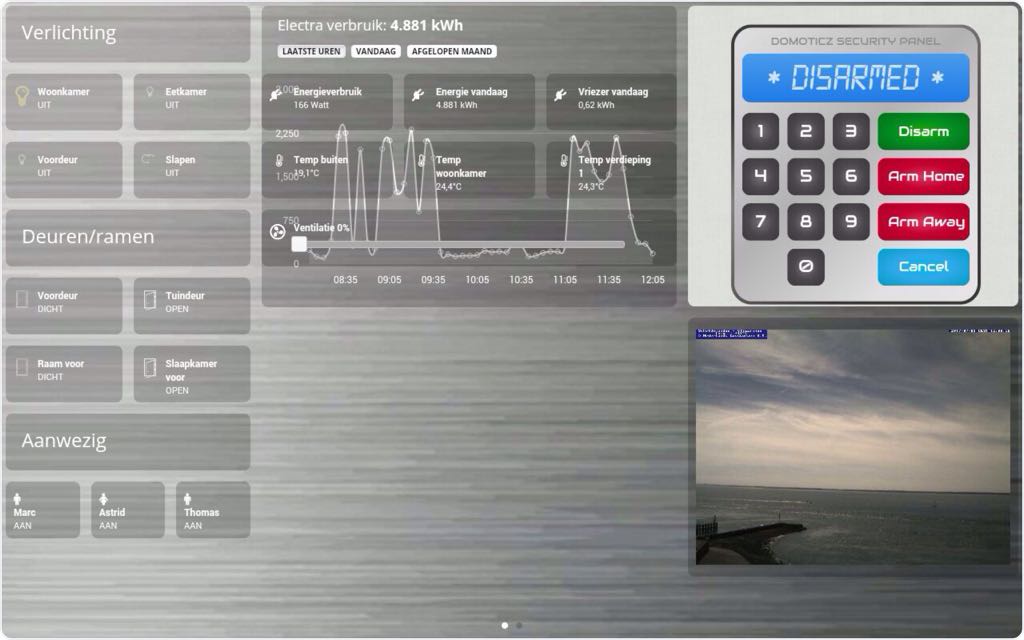

This is what I get when selecting 'laatste uren' or 'afgelopen maand'
What have I been doing wrong here?
Other question: How can I make the white surrounding of the secpanel transparent?
My CONFIG.js:

I like your setup. I don't know how, but I don't have the 'uren' problem anymore. Do you hve the latest beta? Maybe that changed things

EdKo66 wrote:I like your setup.
Thnx! :)
EdKo66 wrote:I don't know how, but I don't have the 'uren' problem anymore. Do you hve the latest beta? Maybe that changed things
It's the latest beta I think, I installed it on July 6.
