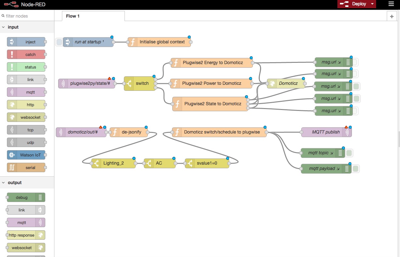

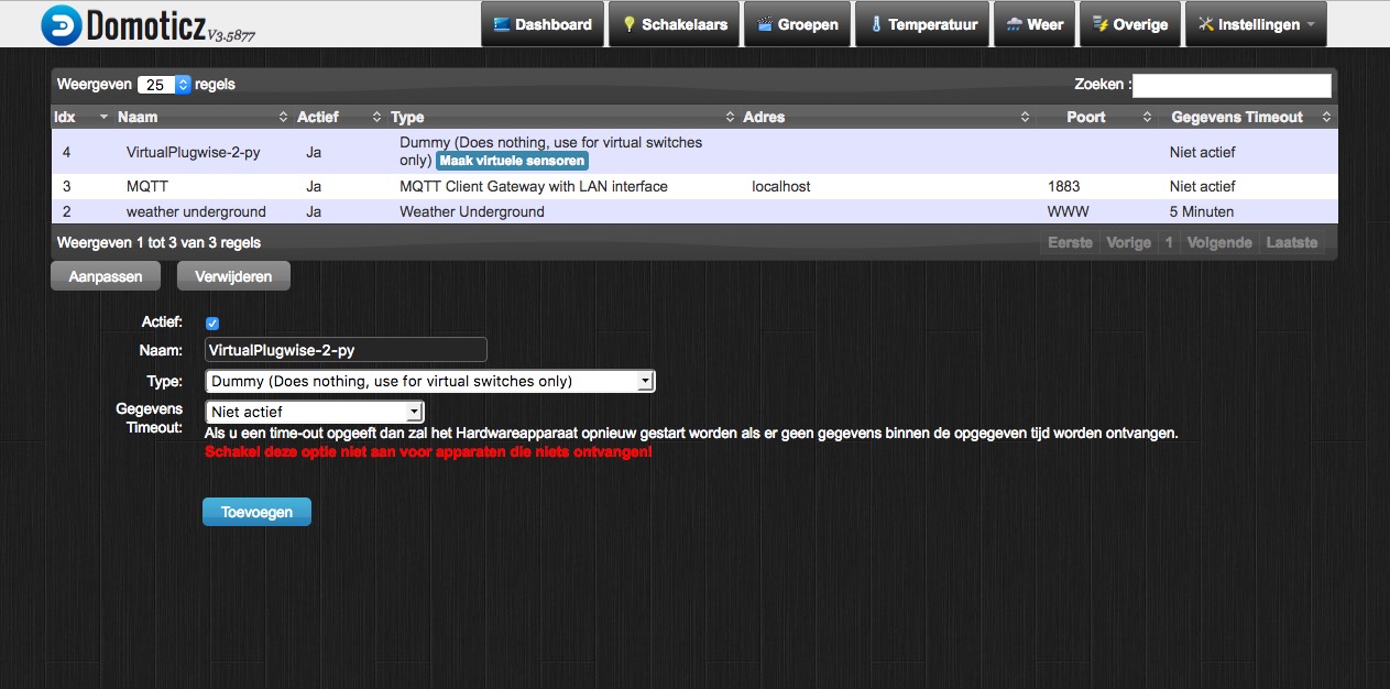

Stuggling to get this to work. Plugwise runs in 1 pi, domoticz (and mqqt / node-red) on another
What works:
Plugwise-2 and Plugwise-2-web both run. I can change devices via the web interface and I can see power usage (yay)
Logs also show that the buffers are bing read and recorded
On domoticz:
- HW MQTT gateway installed on localhost idx 42
- node-red config updated to use idx 42 and localhost (127.0.0.1, default)
- node-red sees incoming messages:
Dec 5 22:47:01 domoticz Node-RED[449]: 5 Dec 22:47:01 - [info] [function:Plugwise2 Power to Domoticz] Relay Plugwise MQTT power message to Domoticz HTTP
Dec 5 22:47:01 domoticz Node-RED[449]: 5 Dec 22:47:01 - [info] [debug:msg.url] http://127.0.0.1:8080/json.htm?type=com ... e=241.36;0
using mosquitto_pub, I can update a virtual switch in domoticz from the other pi
Problem: no devices are being created (either with accept new hardware devices on or off)

What works:
On domoticz:

NVM, turned out that domoticz was not accepting any calls from localhost and wanted the IP instead.
Is it normal to have 3 devices per plug: 1 on, 1 off and one power?

I have followed the link https://github.com/SevenW/Plugwise-2-py ... cz.nodered
I put the code into Node red and said import. The link does not tell me what to do next. I have a Plugwise stick 1 Circle + and 7 circles
https://www.domoticz.com/forum/download ... w&id=11643

indeed this is where the readme stops. I struggled here as well since it was my first time to use node-red. You changed the Idx in the node to point towards your virtual device i assume? If so, press the 'deploy' button in the top right corner.. press this and your circles should appear:)walberg wrote:I have followed the link https://github.com/SevenW/Plugwise-2-py ... cz.nodered

I have the following situation:
- I have devices added
11 VirtualPlugwise-2-py B416BCAE 1 Overloop on Lighting 2 AC On - - Zet als ongebruikt Naam wijzigen Log 2018-03-12
12 VirtualPlugwise-2-py C416BCAE 1 Overloop off Lighting 2 AC Off - - Zet als ongebruikt Naam wijzigen Log 2018-03-12
- I can switch on/off devices with mosquitto, i can see changes in the bulb
(mosquitto_pub -h localhost -t "domoticz/in" -m '{ "idx" : 11, "nvalue" : 0 }')
- but in real live the bulb is not switching on or off at all

I am stuck at this moment connecting my plugwise circles to Domoticz.
Everything seems to work fine except the connection between node-red and Domoticz. I do see data in the data-log folder but fail to import it in Domoticz via node-red.
I have created the Virtualplugwise-2-py hardware and entered the idx in node-red but the circles don't pop-up in the list.
Does anybody know where to look for errors? Is there a node-red logfile? My experience with the command line is limited but I learn by trial and error.
