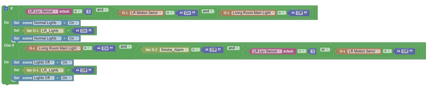

Re: Turn Light On
Post by Padster »
See if I've got this right :)
It the LR PIR is on AND (LR Lights Auto=on AND LR Updown Light=off)
AND
Living Room < 100
SET Updown Lights Level= 5%
I need to learn Blockly better than I have.

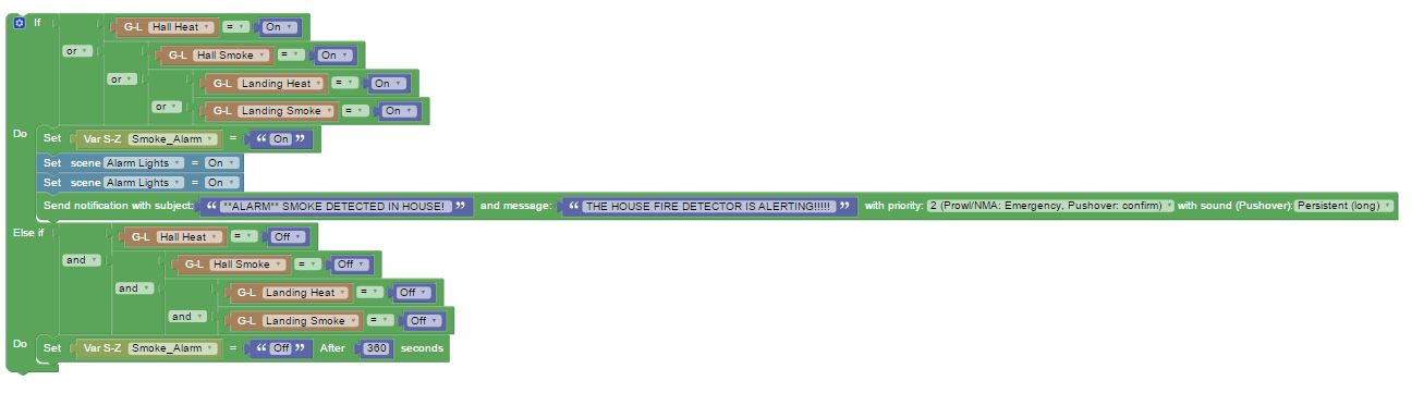

Would this smoke/heat detection work?
Basically if any of the smoke or heat detectors are ON then Set Smoke_Alarm variable to 'On', turn the Alarm Lights On and send a notification.
Else
If all the Heat and smoke sensors are Off set the variable Smoke_Alarm to 'Off' after 6 mins
StanHD
Posts: 347
Location: East Sussex, UK
Re: Turn Light On
Post by StanHD »
Yes the interpretation of my Blockly is correct :)
Regarding your Blockly, it looks OK to me, however I always use numbers in user variables, but that's just me. Perhaps you could mock something up with some dummy switches to test?

Padster
Posts: 21
Joined: Friday 26 May 2017 20:25
Re: Turn Light On
Post by Padster »
Thanks again.
My Blockly did work when the 'AND' and 'OR' conditions were all inline. Just not sure is nesting them changed the interpretation. I know the order of evaluation is important.
