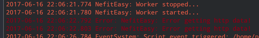

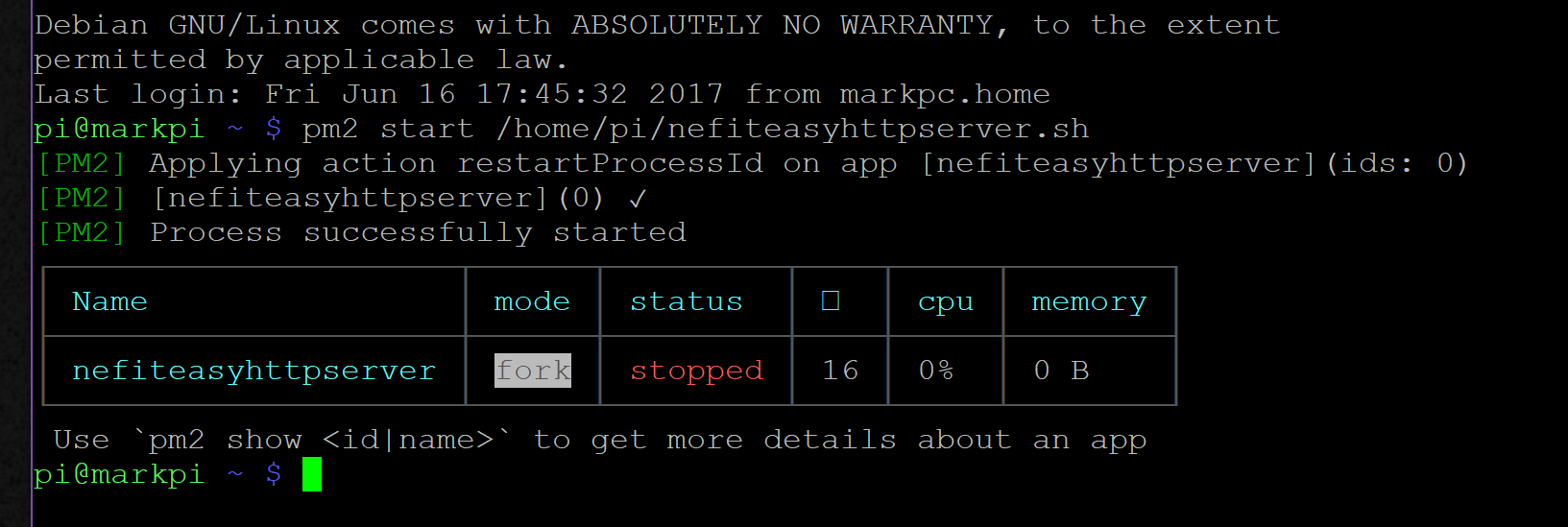

I have installed the nefiteasy on my rpi. But I still get error codes in Domoticz and the service stops after it is started up (see screenprint). Anyone any idea what's going wrong?
This is the error code I get in Domoticz:
2017-06-16 22:03:57.740 Error: NefitEasy: Error getting http data!
In hardware in Domoticz I use ip adress of rpi and port 3000. The IP adress of rpi is also in the easynethttpserver.sh.
Can anyone help me solving this issue?

I get this error when I use the node command:
module.js:328
throw err;
Error: Cannot find module '/usr/bin/easy-server'
at Function.Module._resolveFilename (module.js:326:15)
at Function.Module._load (module.js:277:25)
at Function.Module.runMain (module.js:430:10)
at startup (node.js:141:18)
at node.js:980:3
