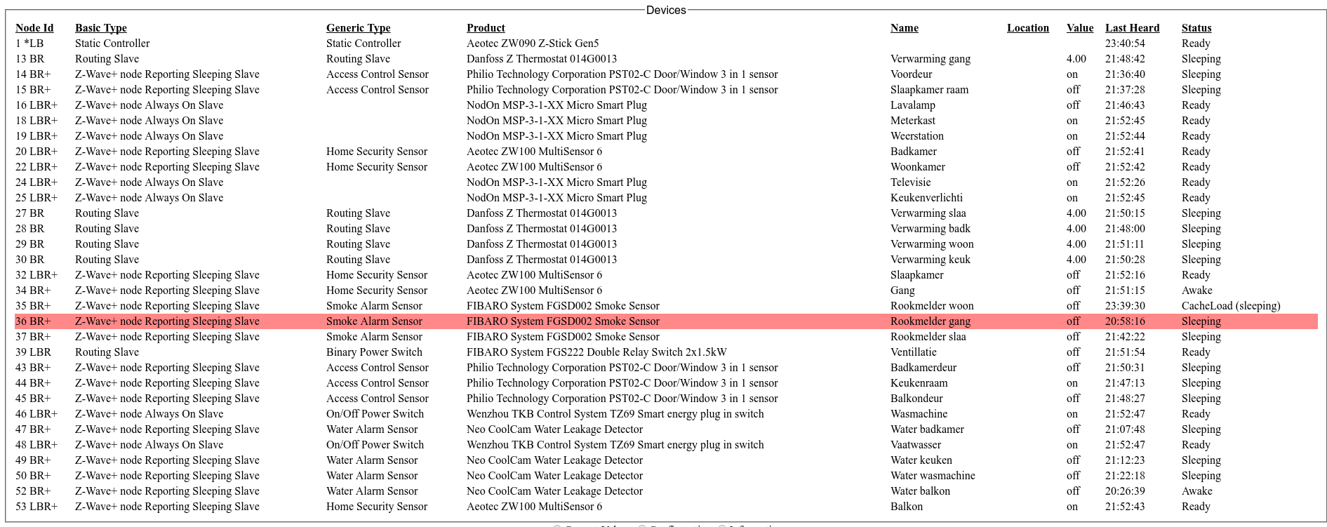

I've got one Z-wave node (Rookmelder woonkamer) that isn't waking up anymore to the network. It's a Fibaro smoke sensor v2. I've already pressed the buttons on the thing to wake it up, but no luck. I've also tried to heal the network, but no luck either.
I've attached 2 screenshots:
the openzwave control panel: the sensor is not responding.

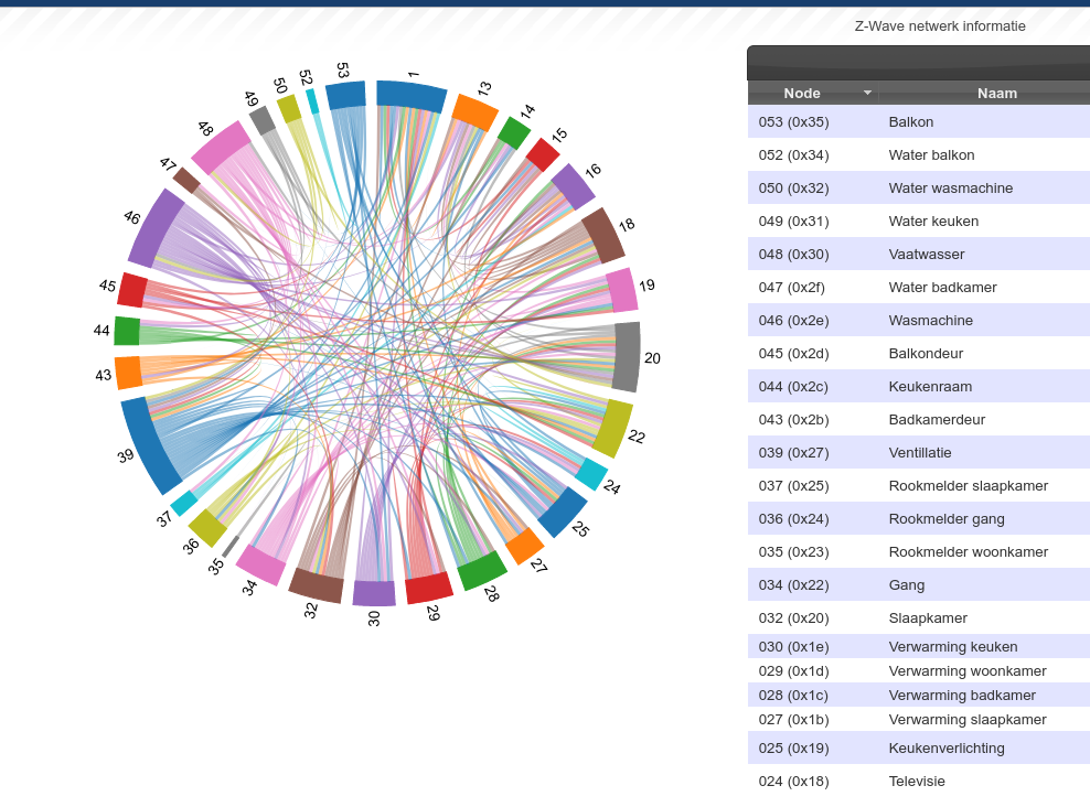

the network topology: the sensor is no longer connected to the network (as far as I can see).
The sensor is almost next to a Nodon switch (Weerstation), so it should be in range of the network. Furthermore I've taken it next to the Raspberry Pi and tried to wake it up. I cannot get the thing to connect.

OK so it's not a problem with the Device - for some reason the system has got stuck on that node in the CacheLoad phase - mine does this on rare occasions - with both sleeping nodes as well as awake nodes. All I do is go to the Domoticz hardware tab, disable the ZWave hardware for 5 seconds and then re-enable the ZWave hardware again. I find it is more likely to happen after a full system reboot - and doing this seems to fix it.
