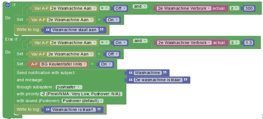

I've had the same idea a little while ago, and this is how i solved it.
I'm using a Fibaro Wall Plug to measure its power consumption, when it uses 300watt or more a variable sets to on and writes it to the log.
Next it's waiting until the power consumption becomes 1.3 watt (ready, but the display on the washing machine still lid, 15 minutes later the display will turn off and power consumption will be 1 watt)
Then send a message, and turn on the most left light above the dining table.
Works like a charm and has a huge WAF (Wife Acceptance Factor)
Domoticz Wasmachine.png (43.14 KiB) Viewed 3731 times

Goldwing1973 wrote: Sunday 17 September 2017 21:49 I've had the same idea a little while ago, and this is how i solved it.
Thanks for sharring.
If the script doesn't work for me I can always try your Blocky. Blocky is more my language then LUA :oops:
Luigi87
