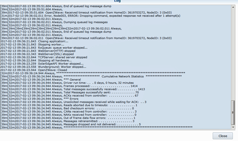

Another issue I could use help with .. I had the Aeontec HEM gen5 working just fine, for a while, but at about 20:45 last night the devices stopped receiving data, and I can't get them to revive (I have not disconnected them from the Z-wave network, but I've tried everything else). I can get them fine from a copy of the domoticz installation running on the PC, but on the Synology 'no data'.
Looking at the log, it seems I am getting copious timeouts for whatever reason. I see them occasionally on the PC too, but the PC seems to retry and eventually succeed, whereas the Synology version just seems to give up .. log attached. Suggestions welcome - is there some way to tell the Synology package to 'keep trying', or do I just have an issue with the Energy Meter itself?
download/file.php?mode=view&id=9710
- SynZWave.png (170.36 KiB) Viewed 6304 times

2017-02-16 21:16:17.595 OpenZWave: Version: 1.4-2398-g0623c10-dirty
2017-02-16 21:16:17.595 OpenZWave: using config in: /usr/local/domoticz/Config/
2017-02-16 21:16:17.785 OpenZWave: Driver Ready
2017-02-16 21:16:17.797 OpenZWave: Value_Added: Node: 3 (0x03), CommandClass: METER, Label: Count, Instance: 1
2017-02-16 21:16:17.798 OpenZWave: Value_Added: Node: 4 (0x04), CommandClass: SWITCH BINARY, Label: Switch, Instance: 1
2017-02-16 21:16:19.651 OpenZWave: Value_Added: Node: 3 (0x03), CommandClass: METER, Label: Count, Instance: 1
2017-02-16 21:16:19.763 OpenZWave: All Nodes queried
Windows7 PC version
2017-02-16 21:25:38.952 OpenZWave: Starting...
2017-02-16 21:25:38.952 OpenZWave: Version: 1.4.2340.g63fa7f6.dirty
2017-02-16 21:25:38.953 OpenZWave: using config in: C:\Program Files (x86)\Domoticz\Config/
2017-02-16 21:25:39.127 OpenZWave: Driver Ready
2017-02-16 21:25:39.132 OpenZWave: Value_Added: Node: 3 (0x03), CommandClass: METER, Label: Energy, Instance: 1
2017-02-16 21:25:39.132 OpenZWave: Value_Added: Node: 3 (0x03), CommandClass: METER, Label: Power, Instance: 1
2017-02-16 21:25:39.132 OpenZWave: Value_Added: Node: 3 (0x03), CommandClass: METER, Label: Voltage, Instance: 1
2017-02-16 21:25:39.132 OpenZWave: Value_Added: Node: 3 (0x03), CommandClass: METER, Label: Current, Instance: 1
2017-02-16 21:25:39.132 OpenZWave: Value_Added: Node: 3 (0x03), CommandClass: METER, Label: Unknown, Instance: 1
2017-02-16 21:25:39.134 OpenZWave: Value_Added: Node: 4 (0x04), CommandClass: SWITCH BINARY, Label: Switch, Instance: 1
The OZW control panel shows the device (in both cases) with data coming in and the same parameters (as far as I can tell) so the issue is maybe with the way OZW is linking into domoticz devices.
synology startup ..
2017-02-16 21:16:17.594 OpenZWave: Starting...
Windows7 PC version
