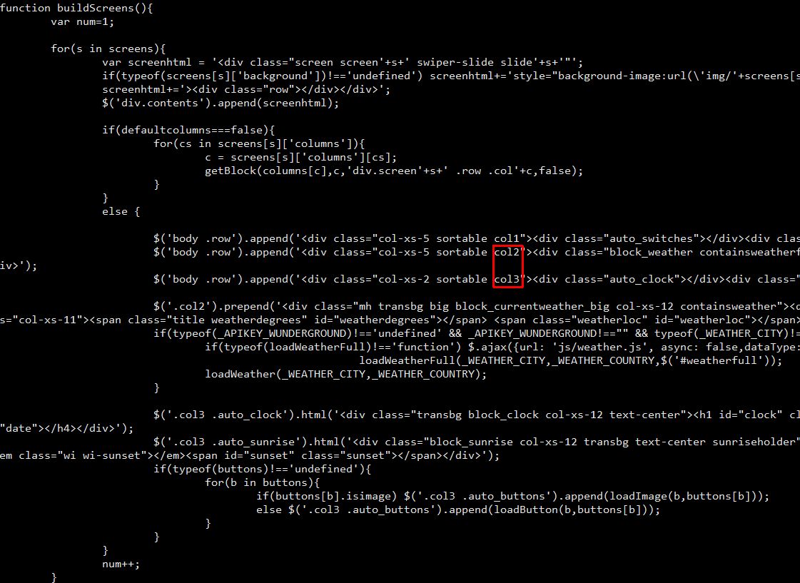

Hesmink wrote:
Hesmink wrote:
robgeerts wrote:
Please post your config.js withouth credentials!
This shows switches and the daily weather icons, nothing more (xxxx'd out my WU api key).
Since the json query retrieves all devices, I also temporary added '&favorite=1' to the query to see if one of my devices was interfering. Same results.
No errors in the Chrome debugging console.
Swapping around files from the old and new installation points to main.js, but it's too complicated for me to undertstand what's wrong here.
Adding to this, the difference between the original code, and the new code seems the be references to .col2 and .col3:
The body .row stuff displays, but anything referring to col2 and col3 is not displaying.
dashtics issue - fixed.jpg (149.99 KiB) Viewed 3792 times
Fixed it by re-adding definition of col2 and col3. This would only affect people using the default set.
