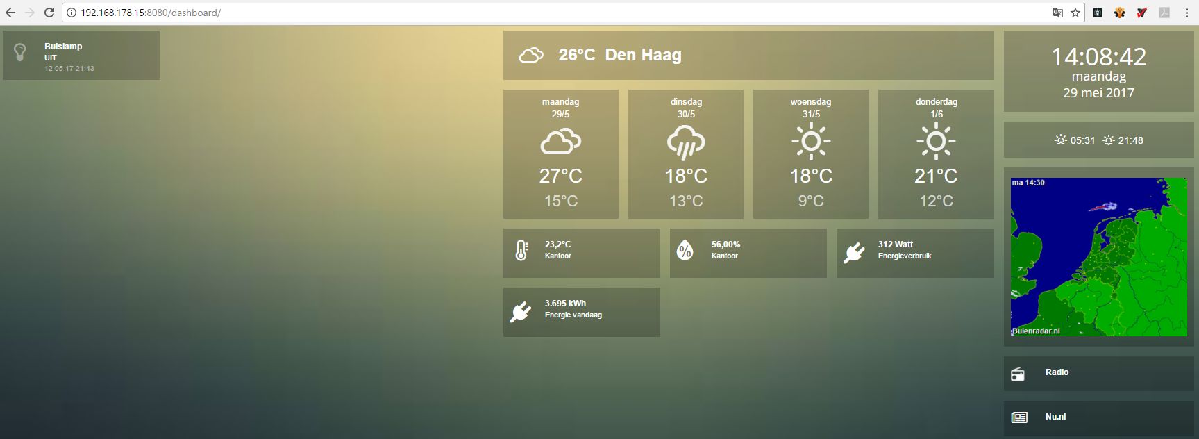

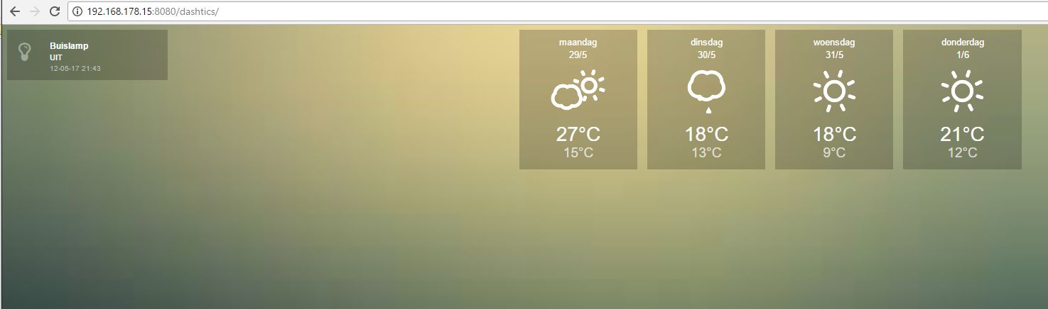

Hesmink wrote:Hi I also have an upgrade problem.
With the end of april version, I can see all the default stuff, to the left all my switches, in the middle weather/temp/energy, and to the right rain radar etc.
I did a git pull of both the beta and release to a fresh folder, and only modified the domiticz ip/port in CONFIG.js. Nothing more.
The result is I only see my switches (the left part), not the rest. Also putting the working CONFIG.js from the april version gives me the weather icons in addition, but nothing more.
What can be wrong, and how do I debug this?
Updated RPi software, latest Domoticz Beta, and latest git pull of Dashtics, but the problem is still there.
I removed most stuff from the Domoticz default page:
Now, this shows with the end of april version:
And this with the latest and greatest:
Any tips of how to debug this?

Hesmink wrote:
robgeerts wrote:
Hesmink wrote: Any tips of how to debug this?
Please post your config.js withouth credentials!
This shows switches and the daily weather icons, nothing more (xxxx'd out my WU api key).
Since the json query retrieves all devices, I also temporary added '&favorite=1' to the query to see if one of my devices was interfering. Same results.
No errors in the Chrome debugging console.

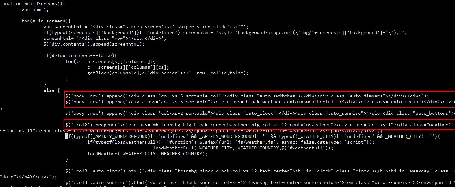

Swapping around files from the old and new installation points to main.js, but it's too complicated for me to undertstand what's wrong here.
Adding to this, the difference between the original code, and the new code seems the be references to .col2 and .col3:
dashtics issue.jpg (160.22 KiB) Viewed 2987 times
The body .row stuff displays, but anything referring to col2 and col3 is not displaying.
