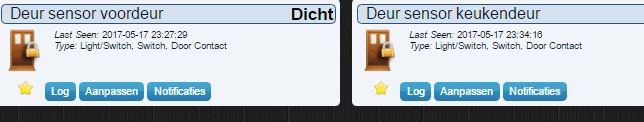

help me out - can you give me a screenshot of them in Devices on Domoticz?
qwerk
Posts: 222
Joined: Tuesday 22 July 2014 7:21
Re: Amazon Echo to Domoticz Bridge: switches, sensors & more
Post by qwerk »
yes we can.

Madgeni
Posts: 1571
Post by Madgeni »
ok, so subType (if you check the Devices page), is "Door Contact"?

qwerk
Posts: 222
Post by qwerk »
after uploading new version no erros in logs.
wrong type I guess

qwerk
Posts: 222
Post by qwerk »
see pm ( in 1 minute)

qwerk
Posts: 222
Post by qwerk »
I can not get devices recognized as door locks/contacts, sorry
"applianceId": "1039",
"manufacturerName": "Weer-script",
"modelName": "Switch",
"version": "Door Lock",
"friendlyName": "door study",
"friendlyDescription": "Light/Switch",
"isReachable": true,
"actions": [
"incrementPercentage",
"decrementPercentage",
"setPercentage",
"turnOn",
"turnOff"
"additionalApplianceDetails": {
"maxDimLevel": 100,
"switchis": "Door Lock",
"WhatAmI": "light"
