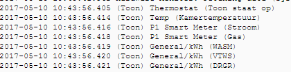

So as you know, Toon data is working with my PI and Domoticz.
Domoticz turn my lamps on when the sun goes down, and turn it off when it is 11pm.
I really dont know why it willl not work on you're NAS Edwin.. I will search it out for you.. I don't and can't believe that it working by me, not by you..
I do not want to accept that, If it works with me, it should be possible with you too! :x

SteGe wrote:But did you do something special to get it working? Because I couldn't get any connection with Toon and I'm using a pi...
No.. I just login in Domoticz with my mijn eneco username and password, and its working..
Screens:
Anyone can build a fast processor. The trick is to build a fast system.

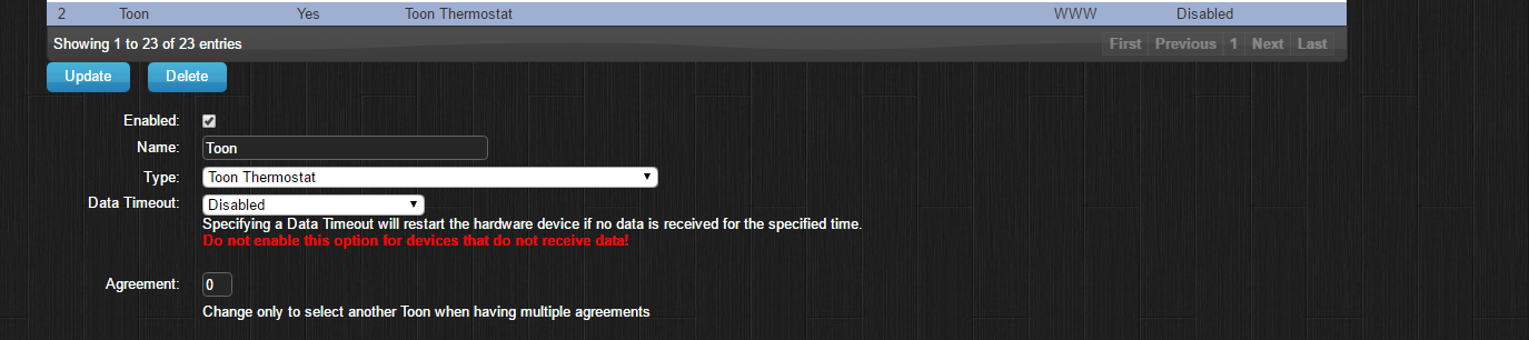

EdwinK
Posts: 1820
Location: Rhoon
Re: TOON died within Domoticz
Post by EdwinK »
bertbigb wrote:At my home Toon is working stable with Synology and Domoticz beta V3.7416
I can set the set point. I get values from gas and electricity usage. It tells when the heater is burning. If warm water is used and it does this already for months.
So if it works fine at my place and at other places, the problem is most likely at the configuration. So please share with us a few screenshots of your configuration and log files. Hope one of us can help to get it working.
Screenshot Toon
Screenshot Toon
Screen Shot 2017-05-10 at 12.03.39.png (42.97 KiB) Viewed 2900 times
Just started the service again, to create the logfiles.
2017-05-10 12:08:47.106 Error: ToonThermostat: Error getting current state!
2017-05-10 12:13:51.437 Error: ToonThermostat: Error login!
Username and password are correct, as they are the same for the Eneco forum and website. Also allowed for new sensors to be found.

(O. I should have pressed 'submit' instead of 'preview', or the post will never be send)
Plantje
Posts: 451
Joined: Friday 16 October 2015 7:58
Post by Plantje »
Strange... mine is working as well. I thought Domoticz uses the website to get the data. Isn't that the case?
EdwinK
Posts: 1820
Location: Rhoon
Post by EdwinK »
Yes. It uses the former toonopafstand.nl. Site is down, but it seems that the backend is still running. It would be nice if we could get it from Toon it self, using it's VPN connection.
