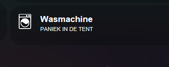

Sorry it seens I have a different problem:qwerk wrote:but if you use the orginal text is does work. as a work aroundSuperMouse wrote:I have the exact same issue..SwordFish wrote:
So i set variable _SHOW_LASTUPDATE = true and it works with the lines lastupdate in custom.js.
Now i have to set in all blocks that i dont want lastupdate to false.
I had it set variable _SHOW_LASTUPDATE = false and in some blocks i set show last update = true and that works.
But for some reason that doesn't work when you use custom.js to modify some text for switch.
Thanks for the help
the modified text will/can still be used with the device
I have a waterdetector under the washing machine what give other statuses.
Wasmachine water detector
blocks[164] = {}
blocks[164]['image'] = 'wasmachine.png'
blocks[164]['title'] = 'Wasmachine';
blocks[164]['width'] = 12;
function getBlock_164(device,idx){
$('.block_'+idx).attr('onclick','switchDevice(this)');
var html='';
html+='<div class="col-xs-4 col-icon">';
if(device['Status']=='Off') html+=iconORimage(idx,'fa-toggle-off','','off icon');
else html+=iconORimage(idx,'fa-toggle-on','','on icon');
html+='</div>';
html+='<div class="col-xs-8 col-data">';
html+='<strong class="title">'+device['Name']+'</strong><br />';
if(device['Status']=='Alarm') html+='<span class="state">PANIEK IN DE TENT</span>';
else html+='<span class="state">OK</span>';
html+='</div>';
return html;
- was paniek.png (7.7 KiB) Viewed 2864 times
- was ok.png (4.81 KiB) Viewed 2864 times
