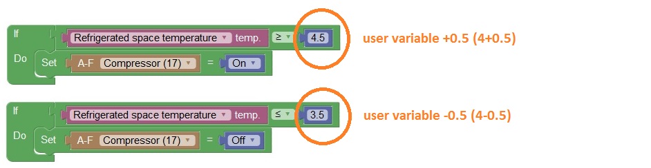

To test my cooling cycle I've made two fixed events.
When the room temperature is over 4.5 degrees the refrigerator compressor turns on.
When the room temperature is below 3.5 degrees the refrigerator compressor turns off.
In this way I made a 1 degree hysteresis. This runs fine for a few days now.
What I would like to do is a little calculation in the Events. I want to set
one user variable Temperature and let the system calculate the on and
off temperatures by adding or subtracting 0.5 degrees.

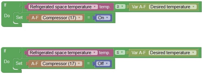

Great! I have the thermostat working now.
Now I'm trying to figure out how I can make the hysteresis in the system...
because the compressor will turn off and on if I use the system like this:
no hysteresis.jpg (47.12 KiB) Viewed 2821 times

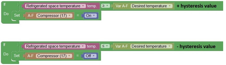

I need to add or subtract a value from the desired temperature like this:
hysteresis 1.jpg (55.63 KiB) Viewed 2821 times
But this seems not to be possible within the event system.
Is there a way you can make a user variable which is made like:
"low value = Temperature setpoint - 0,5 degree"
"high value = Temperature setpoint + 0,5 degree"
In this way I could use these variables in the events to switch the
compressor with a hysteresis of 1 degree...
Thanks in advance!

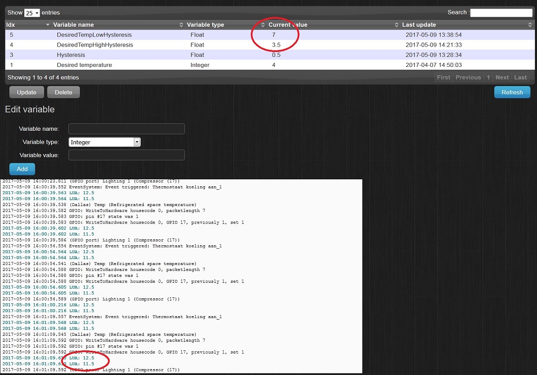

pff a lot of searching in examples. But this seems to read my thermostat. BUT!!!
The "DesiredTempHighHysteresis" and "DesiredTempLowHysteresis" do output the correct value in the lua scrypt
but the values are not updated in the graphic environment. The 3.5 and 7 degree are also seen by the blockly scripts.
no update.jpg (221.88 KiB) Viewed 2800 times
So I seem to have a little error in my code... Any ideas?
Regards, Roland

It seems I have forgotten the part: Variable:
Now the variables are getting synchronized...
commandArray["Variable:DesiredTempHighHysteresis"]= tostring(otherdevices["Temperature setpoint"] + uservariables["Hysteresis"])
commandArray["Variable:DesiredTempLowHysteresis"]= tostring(otherdevices["Temperature setpoint"] - uservariables["Hysteresis"])
print (commandArray["Variable:DesiredTempHighHysteresis"]);
print (commandArray["Variable:DesiredTempLowHysteresis"]);
