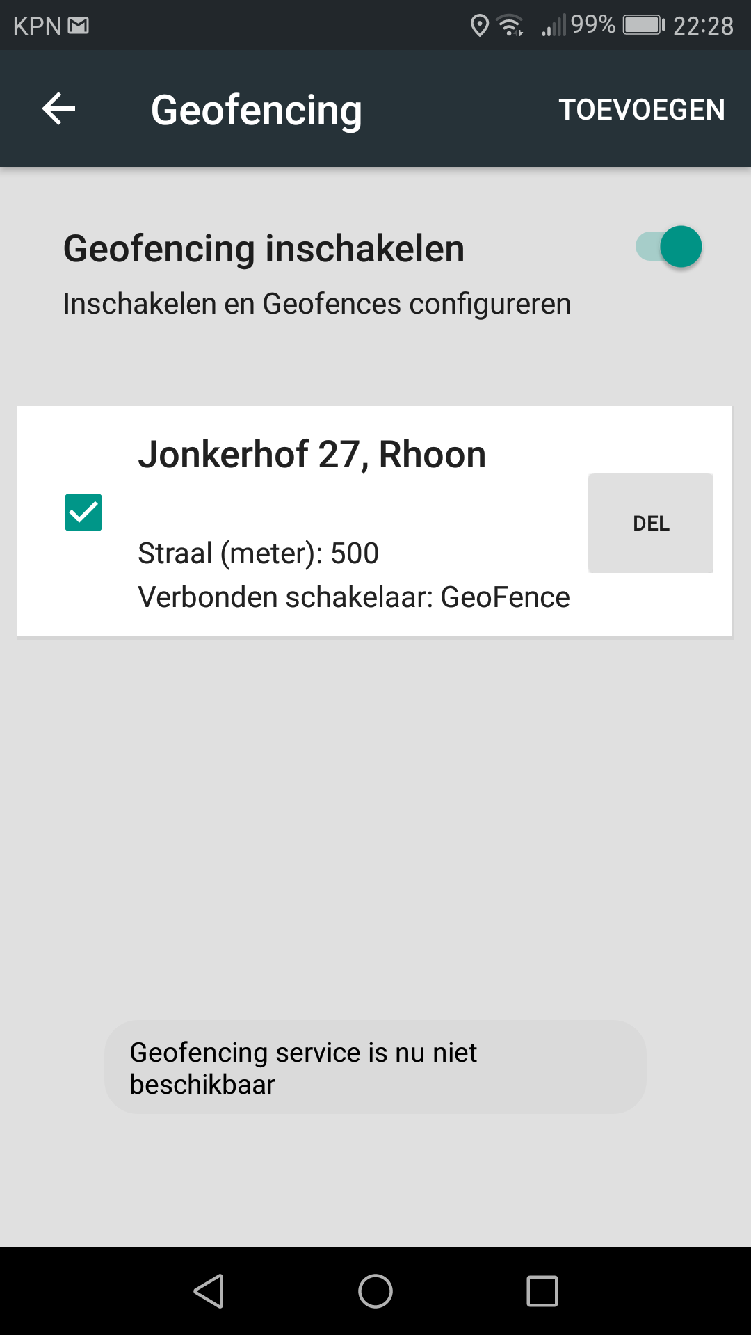

Recently bought the app, mostly for the Geofence. But when I activate the geofence, it shows 'Geofence not available' (or something like that in Dutch.
App version. 0.1.393 (2798) on Android version 7.
When I check the log of the switch, I can't see anything happening there.

Please explain the steps what you do, maybe you can make/upload screenshots.EdKo66 wrote:Recently bought the app, mostly for the Geofence. But when I activate the geofence, it shows 'Geofence not available' (or something like that in Dutch.
So as soon as you enable the geofence feature, you get this exception?
Or when you assign a geofence to a switch?
Or when you enable the geofence (already connected to a switch and then turned on by the checkbox)?

galadril wrote:EdKo66 wrote:Recently bought the app, mostly for the Geofence. But when I activate the geofence, it shows 'Geofence not available' (or something like that in Dutch.
When I check the log of the switch, I can't see anything happening there.Please explain the steps what you do, maybe you can make/upload screenshots.
This happens as soon as I enter the Geofencing option in the app. 'Geofencing Service is nu niet beschikbaar'. ;When I want to add to a switch, the app asks for the password, and after that, returns with the same error message.Or when you assign a geofence to a switch?Or when you enable the geofence (already connected to a switch and then turned on by the checkbox)?

@EdKo66 Seems like your phone does not permit the app to use location information. I only know about IOS, but do you have a security setting somewhere (dis)allowing programs to access location information?

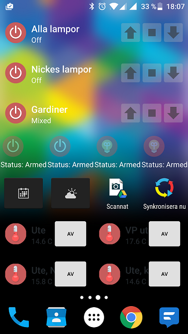

So, new beta. Messed up widgets. Again. This is no problem that could be solved? Tired of removing and adding widgets every time the app updates. :/

gerard76 wrote:@EdKo66 Seems like your phone does not permit the app to use location information. I only know about IOS, but do you have a security setting somewhere (dis)allowing programs to access location information?
Not sure, will check on this some later time. Very busy atm

+1NiklasO wrote:So, new beta. Messed up widgets. Again. This is no problem that could be solved? Tired of removing and adding widgets every time the app updates. :/
Very annoying, I also need to fix my wife's phone too. Happened almost every update lately?

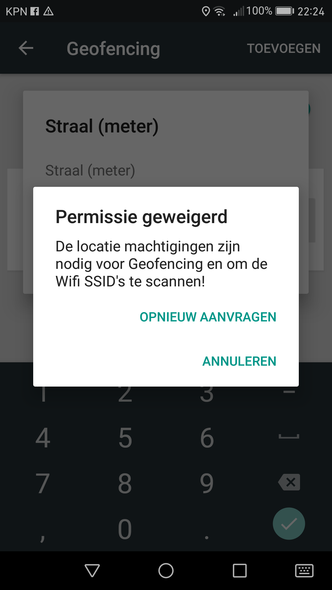

Same issue over here when adding or edditing geofence settings. Geofence isn't working right now.EdKo66 wrote:galadril wrote:EdKo66 wrote:Recently bought the app, mostly for the Geofence. But when I activate the geofence, it shows 'Geofence not available' (or something like that in Dutch.
It looks like something is changed after the latest app-update (live version, non beta).Or maybe after the latest Android Update (Galaxy S8 android 7.0)
The app-permissions are correct. The app has location-permissions.

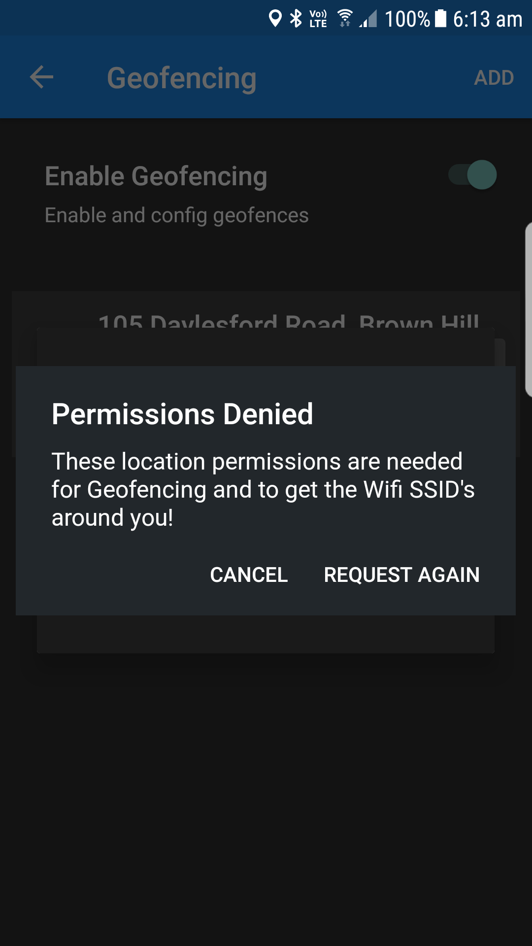

Greetings, first of all, thanks for developing this app, I love it. However, it is not without issues. Geofencing, for example, appears to have a couple of issues. The first one is I am getting the error message “These location permissions are needed for geofencing and to get the Wifi SSID’s around you.” I have seen that others are having the same issue but I don’t know how to resolve it. Where do I set the permissions required? Perhaps having this information at the beginning of the forum as a sticky post would be useful for others like me. [img][/img]
The other issue I am having which is a lot more irritating, I am getting a lot of phantom alerts, the app will notify me that it has left the zone when the phone is sitting on my desk. A few seconds later it will say its back in the zone again and the phone hasn’t moved at all. It will do this over and over again. I wonder if this maybe a power saving issue. I am in a good signal coverage area so I don’t believe this is related to loss of mobile connection. I have Wi-Fi turned on as well but this doesn't seem to make any difference.
The software version is 7.0 build number NRD90M.G935FXXU1dQBF and the phone is a Samsung galaxy S7.
