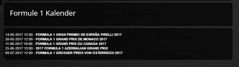

For some reason the ics file was not loaded from lighttpd web server folder. I've put file in /Dashticz/custom folder and working as it should... :D
except time difference

qwerk wrote:I do have a two hour difference to fix.
I found this article about timezone fix... https://erics-notes.blogspot.nl/2013/05 ... -zone.html
Unfortunately the parser is too simple for this...
@wizjos added ConvertUTCTimeToLocalTime, but then this does not helped.
I tested now, with current @wizjos code I have wrong time too.
Could you please guys check the following:
locate these lines in vendor/ical-parse/ical_parser.js:
//var utcdatems = Date.UTC(dtutc.year, (dtutc.month-1), dtutc.day, dtutc.hour, dtutc.minute);
var utcdatems = ConvertUTCTimeToLocalTime(Date.UTC(dtutc.year, (dtutc.month-1), dtutc.day, dtutc.hour, dtutc.minute));
remove last line and uncomment the first one, so it should look like this:
It worked for me.
definitely we need to add ability to set custom offset.

For the 2 hour time issue:
in ical_parser.js i changed:
to
and the time issue is gone :D (last beta)
qwerk
Posts: 222
Joined: Tuesday 22 July 2014 7:21
Re: Dashticz v2.0, custom positioning and multiple screens
Post by qwerk »
yep, both right. it looks ok now.
now hope it gets an setting possibility in config.js.
