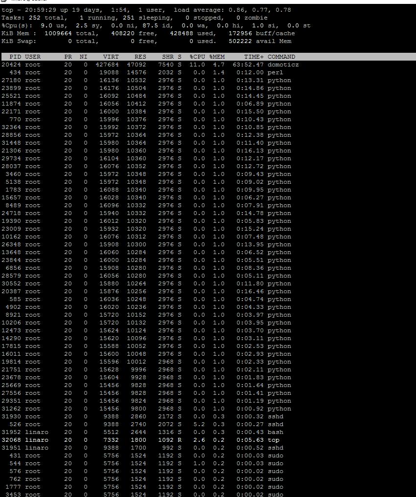

Do you have internal sensors activated? What does the memory and cpu usage say?

Any command for checking CPU / mem stats? i used "top"

try "top -o %MEM" to have top sorted by memory.
You have lots of memory in use, even part of your swap is in use. I never have that on any of my Pies.
If you add "Motherboard sensors" to the Domoticz hardware you'll get graphs of cpu and memory usage.

Wow allot more,

There you see the most memory hungry threads.
Do you need them all? Are you sure you want to run MySQL on a Pi?
And what do you do with Python? Seems that Python took already lots of cpu time.

If you have a good backup you could consider reinstalling a new SD card and start over.
Then, only install what you really need. You'll see that it'll be lots faster and stable.

I don't see MySQL in your list.
Start with removing that one. Could already be the solution.

Sorry That i break in...
Only My board is using a lot of memory and then crash...
With the command : top -o %MEM
I see a lot op phyton.. used by root...
is this normal?
How can witch script is root using?
In my eyes i do use only 4-5 phyton scripts...
