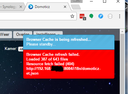

I installed the Beta version with the Python plugin activated and everything I checked sofar works including the buienradar plugin.
Only thing I noticed with this version and not with the previous Beta's is Solved by
/usr/local/domoticz/www/i18n:$sudo cp domoticz-ru.json.gz domoticz-et.json.gz
/usr/local/domoticz/www/i18n:$sudo cp domoticz-ru.json.gz domoticz-lv.json.gz
as described in bug area of this forum
thank you very much for the time and effort. Much appreciated !
- Domoticz_cache_failed.png (57.12 KiB) Viewed 8974 times

@waaren
I know about the Browser Cache bug, and the developers to I think
I will compile/update my packages when this is fixed.
