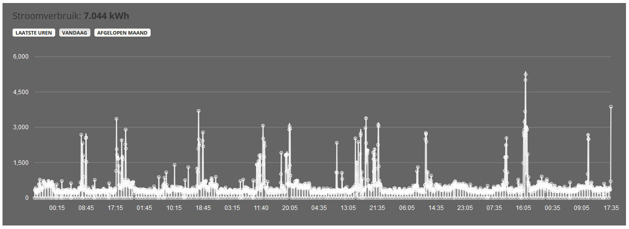

I've got a problem with my graphs, especially the graphs from my energy consumption. If I want to show a graph, my browser freezes for several seconds. After that a graph is shown, but it has A LOT of points. That's the reason why my browser freezes I guess. (see attachement)
Is there a way to avoid the readout of all these points? From the domotiz own webinterface there is no problem reading the graphs.
