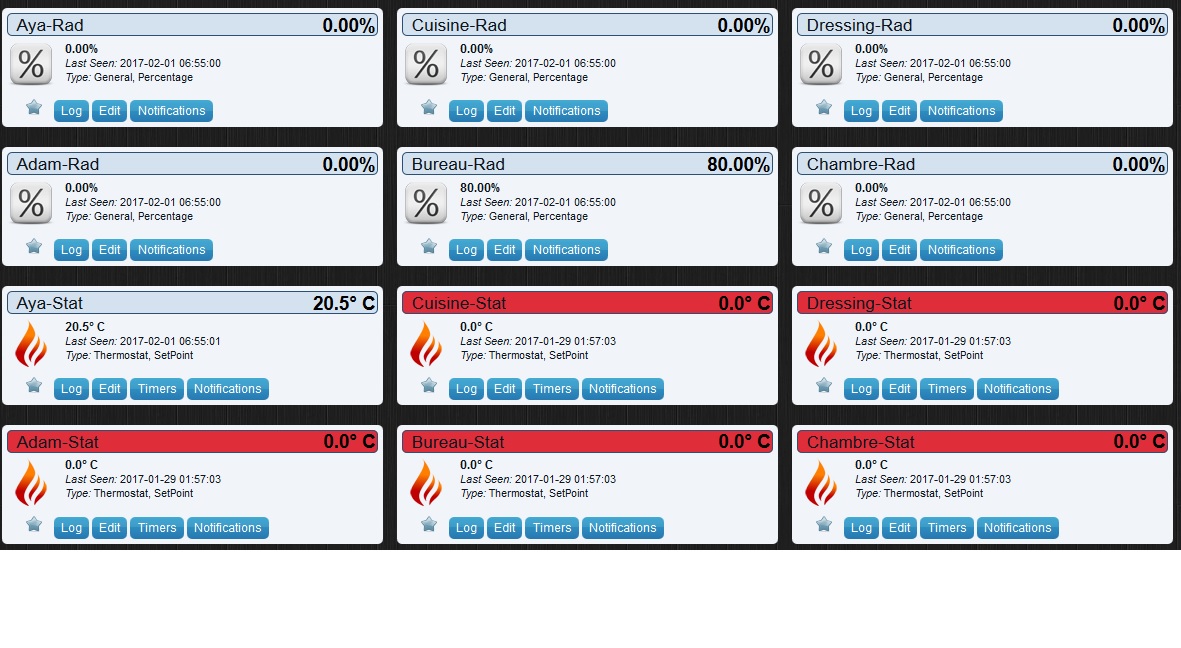

Hello Guys
Folowing the wiki all is ok but the setpoint is not updated except one ( with a thermostat ) but for the vanne I am not able to have any update
can you please help
Is there a way to get also the current temperature from the vanne ... I know it is not really accurate but I am not intersted in buying other thermostat
can you please help

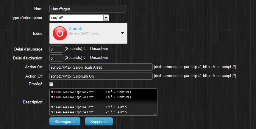

Hello !! Great job, the scripts are realy cool, it's running perfectly on my raspberry 3, great wiki/tutorial !!!daveabbott007 wrote:I have been running the cron version of the script for a while now and it has been perfect - many thanks for all the effort in writing it.
Is there any way to implement a domoticz version of the ECO/AUTO/COMFORT switch?
Many thanks
now I'm programming the switchs, boost, eco etc etc
I've searched how to do, but no success, now I use a new method: I copy the "Trace" log of Max! Home automation (Windows 7) for all commands I need.
only the lines with "s:" are important I obtain this:
Salon-Rad 16A683
s:AARAAAAAFqaDASI= --17°C Auto
s:AARAAAAAFqaDASY= --19°C Auto
s:AARAAAAAFqaDASo= --21°C Auto
s:AARAAAAAFqaDAS4= --23°C Auto
s:AARAAAAAFqaDAcA= -- Boost
s:AARAAAAAFqaDAV4= --15°C Manual
s:AARAAAAAFqaDAWI= --17°C Manual
SDB-Rad 16A682
s:AARAAAAAFqaCAiI= --17°C Auto
s:AARAAAAAFqaCAiY= --19°C Auto
s:AARAAAAAFqaCAio= --21°C Auto
s:AARAAAAAFqaCAi4= --23°C Auto
s:AARAAAAAFqaCAjI= --25°C Auto
s:AARAAAAAFqaCAjY= --27°C Auto
s:AARAAAAAFqaCAsA= -- Boost
s:AARAAAAAFqaCAl4= --15°C Manual
s:AARAAAAAFqaCAmI= --17°C Manual

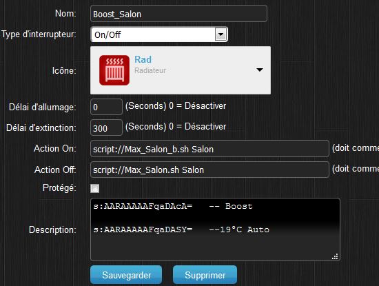

I have only to send the commands when "Switch command ON" or "Switch command OFF" are activated, I use "netcat", a switch for Boost, a switch for eco ...
ex: with bash executable script with arguments,
script://Max_Salon_b.sh Salon (-> s:AARAAAAAFqaDAcA= boost salon) bash:
#!/bin/sh
if [ $1 = "Salon" ]
then
sudo echo 's:AARAAAAAFqaDAcA=' | netcat -C 192.168.2.xxx 62910
fi
if [ $1 = "Sdb" ]
then
sudo echo 's:AARAAAAAFqaCASA=' | netcat -C 192.168.2.xxx 62910
fi
if [ $1 = "Arret" ]
then
sudo echo 's:AARAAAAAFqaDAV4=' | netcat -C 192.168.2.xxx 62910
sudo echo 's:AARAAAAAFqaCAl4=' | netcat -C 192.168.2.xxx 62910
fi
if [ $1 = "SalonCold" ]
then
sudo echo 's:AARAAAAAFqaDASI=' | netcat -C 192.168.2.xxx 62910
fi
if [ $1 = "SdbCold" ]
then
sudo echo 's:AARAAAAAFqaCAiI=' | netcat -C 192.168.2.xxx 62910
fi
I use 2 bash executable scripts (ON and OFF), but you can have 1 script and use 2 arguments too( $1 and $2 ) -> $0 is the command
Now can I use the Max! system in Auto/Manu/Boost mode, I've already programed the Max cube (Standalone week program, if domoticz, or the raspberry don't run), so I need the Auto Mode.

print('Radiateur Salon reglé à: 19°C, T° Extérieure = '..tostring(otherdevices_temperature['Meteo'])..'°C')
-- commandArray['SetSetPoint:18']='20'
if ((otherdevices_temperature['Meteo'] > 15) and (time.hour <= 19) and (time.hour >= 12) and (tonumber(otherdevices['SDB-Stat']) > 21)) then
os.execute('echo s:AARAAAAAFqaCAio= | netcat -C 192.168.2.xxx 62910') --set Salon-Rad 19°C Auto
print('Radiateur Sdb reglé à: 21°C, T° Extérieure = '..tostring(otherdevices_temperature['Meteo'])..'°C')
-- commandArray['SetSetPoint:18']='21'
if ((otherdevices_temperature['Meteo'] > 20) and (time.hour <= 20) and (time.hour >= 9) and (tonumber(otherdevices['SDB-Stat']) > 20)) then
return commandArrayThank you for your scripts, what a job !!!
Re: ELV Max! Heating control system
Instead of using netcat, you could use the MaxCmdSend function of the lua time script
damien7400
- Posts: 5
- Joined: Saturday 06 May 2017 15:48
Hello, I don't know why, it doesn't run,jmbjmbjmb wrote:Hi,
I've explored the scripts, and test the MaxCmdSend but only the manual function run properly, Auto and Boost are not recognized ('maybe?)
