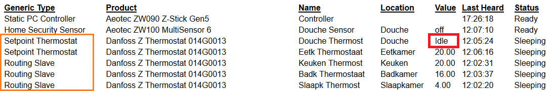

I have six Danfoss Thermostats LC13. They have all different reports on their statuses, settings and other variables.
The Generic Type is sometimes "Setpoint Thermostat" and sometimes "Routing Slave".
The Value for "Douche Thermostat" is "Idle", however, it is functioning well.

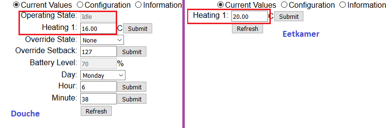

The "Current Values" differ also (just two examples, the others have their own selection of fields):
The "Eetk Thermostaat" is not showing its battery-status in Domoticz.

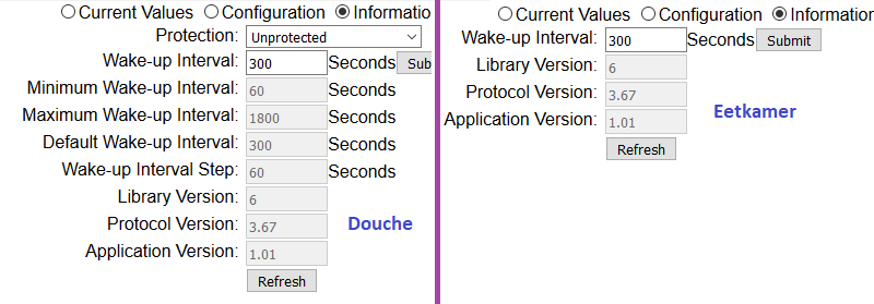

And the "Information" also is different per thermostat:

Does anyone have suggestions why these settings differ and why this also changes over time?
