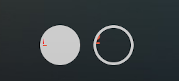

madrian
Posts: 231
Re: Dashticz v2.0, custom positioning and multiple screens
Post by madrian »
robgeerts wrote:Will check some things tonight or tomorrow. @madrian, the bug is caused by your scriot when having more then 1 thermostats. I can look into this.
Ahh thanks! :)
And what about the graphical issue? The corners of the buttons are not clickable + icons are flashing. In original submit they functioned properly, but your buttons are much nicer.

madrian
Posts: 231
Post by madrian »

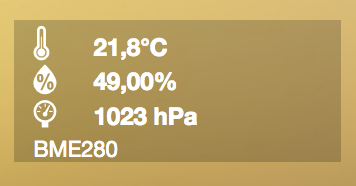

Combined device idea (Temp+Hum+Baro):
Screen Shot 2017-04-21 at 21.50.04.png (34.95 KiB) Viewed 2123 times
We should show combined blocks with a _combined suffix, example:
columns[4]['blocks'] = ['blocktitle_2',48,'24_combined'].
What do you think?

madrian wrote: And what about the graphical issue? The corners of the buttons are not clickable + icons are flashing. In original submit they functioned properly, but your buttons are much nicer.
They are not flashing at my dashboard...
Anyone else with this problem? Maybe its because it is reloading the block every x seconds...
madrian wrote: +look what I found:
Will fix asap!
madrian wrote:Combined device idea (Temp+Hum+Baro):
It's nice but I dont think it fits well for smaller screens... ?
