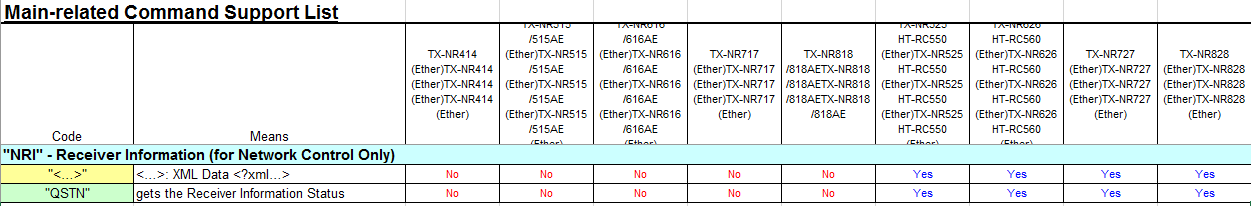

mcwieger wrote:I started using this plugin on my Synology, but it does not seem to work.
I think we are in the same boat.. my 515 and your 616 dont support NRI(QSTN). I found a excel(ISCP_AVR_133 (430940).xlsx) from july 2015 and it stated that:
So for our older receivers we need another way to setup these. Some configuration files based on receiver version name perhaps?
LXC(x64 Ubuntu Xenial), RFXtrx433E, MySensors
I've registered an enhancement on GitHub for supporting receivers that dont deliver the configuration through the NRI command. https://github.com/jorgh6/domoticz-onkyo-plugin/issues

jorgh wrote:I've registered an enhancement on GitHub for supporting receivers that dont deliver the configuration through the NRI command. https://github.com/jorgh6/domoticz-onkyo-plugin/issues
Regards,
Jorg
Nice, thanks! I'll try to help you some day soon and check if wireshark would tell how the onkyo android app is handling with these older receivers.

I added the script using th instructions and restarted domoticz. After I add the hardware my log gets flooded by:
Onkyo 609) Loading XML from file
2017-04-23 18:38:34.297 (Onkyo 609) XML file does not yet exist
2017-04-23 18:38:36.300 (Onkyo 609) Loading XML from file
2017-04-23 18:38:36.300 (Onkyo 609) XML file does not yet exist
2017-04-23 18:38:38.302 (Onkyo 609) Loading XML from file...
jorgh
Posts: 124
Joined: Friday 27 June 2014 23:19
Domoticz version: 3.8224
Re: [RELEASED] Python plugin to control Onkyo receivers
Post by jorgh »
@burton666,
That is probably because the receiver doesn't support the NRI command, they are not supported at this moment as the XML is the basis for creating the Domoticz devices. In a future release I will add support for these receivers. The enhancement is registered at: https://github.com/jorgh6/domoticz-onky ... n/issues/8
