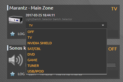

You can use the selector switch for this. It's used in Denon plugin of Dnpwwo.
In that plugin it's possible to change the name of the value in the selector switch, and it can be mapped in the hardware page, so you know which value to send.
See the screenshot below.
Not using Domoticz anymore
If I am reading your code right you are saving the file locally here before sending it to the sonos players:
https://github.com/gerard33/sonos/blob/ ... s.php#L420
This is where I get stuck since the python framework does not support exposing the url's where the Sonos players can read data.
Regaring the selector switch. That is ofcourse possible but to have what all users suggest one user would like to have "Search and play the first found album by artist X", another one wan't to have line in and so on.
One possible solution would be that I Populate the dropdown with all the Sonos favorites that are defined. That way it would be an generic solution even that all the creterias above won't be possible to have.
