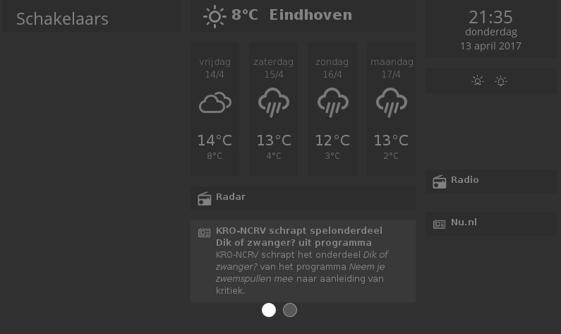

Blueone
Posts: 130
Joined: Friday 29 November 2013 11:30
Re: Dashticz v2.0, custom positioning and multiple screens
Post by Blueone »
I'm using the raspberry touchscreen with the dashboard, I'm already glad there is a stand-by mode. The problem is the touchscreen is very still very bright.
There is a command to adjust the brightness:
echo n > /sys/class/backlight/rpi_backlight/brightness
n is the brightness level 0-255
Also found some sort of API for it: https://github.com/linusg/rpi-backlight
Is there a way I can run this command somewhere in the code when it goes to standby? I also notice the stand-by view isn't completly black and white, see the screenshot, the text is a bit gray but the dot is really white which makes it a better contrast :)

Blueone wrote:I'm using the raspberry touchscreen with the dashboard, I'm already glad there is a stand-by mode. The problem is the touchscreen is very still very bright.
Well, I can only call URL's, (local or internet), so if you can create something wich activates via de browser, I can make a function for this.

Blueone wrote:I also notice the stand-by view isn't completly black and white, see the screenshot, the text is a bit gray but the dot is really white which makes it a better contrast :)
Try latest version
Blueone
Posts: 130
Post by Blueone »
Thanks! Maybe I can create a switch in domoticz which runs a python script or someting :), I'm going to sort this out :) Thanks for the quick reply again!
robgeerts wrote: Try latest version
cool, I'm going to try it.
